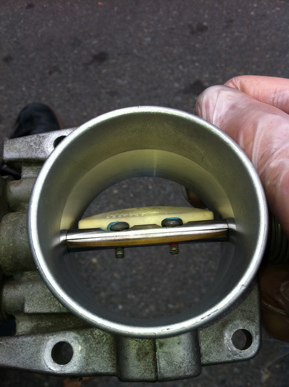

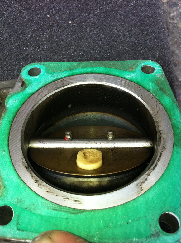

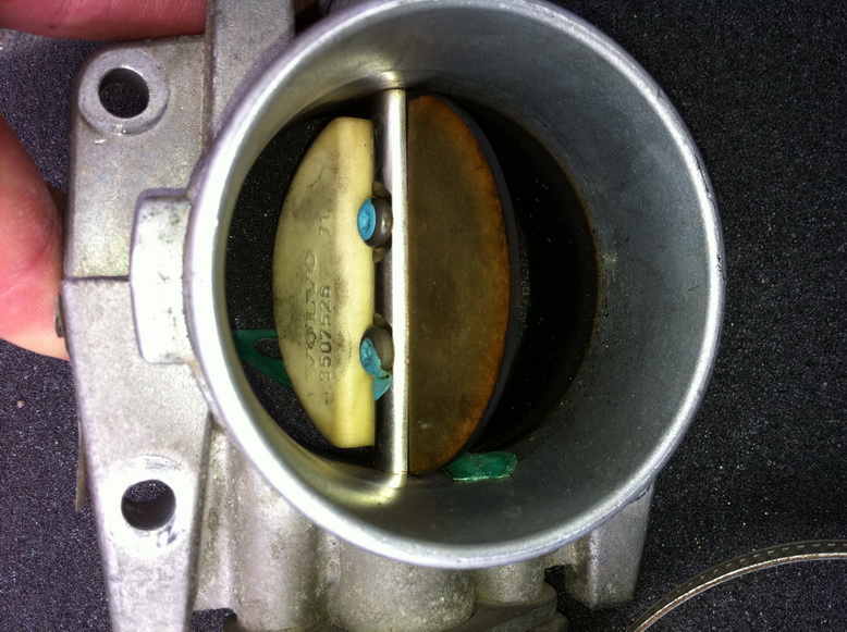

The car stalled again yesterday so I tried a new angle today and cleaned the throttle body. It looked pretty bad - maybe that brings some change. I've read that somewhere that this is associated with engine stalls when idling.
Let's see what happens now. Hope that solved the problem. Thanks for the great instructions concerning how the clean the TB.
