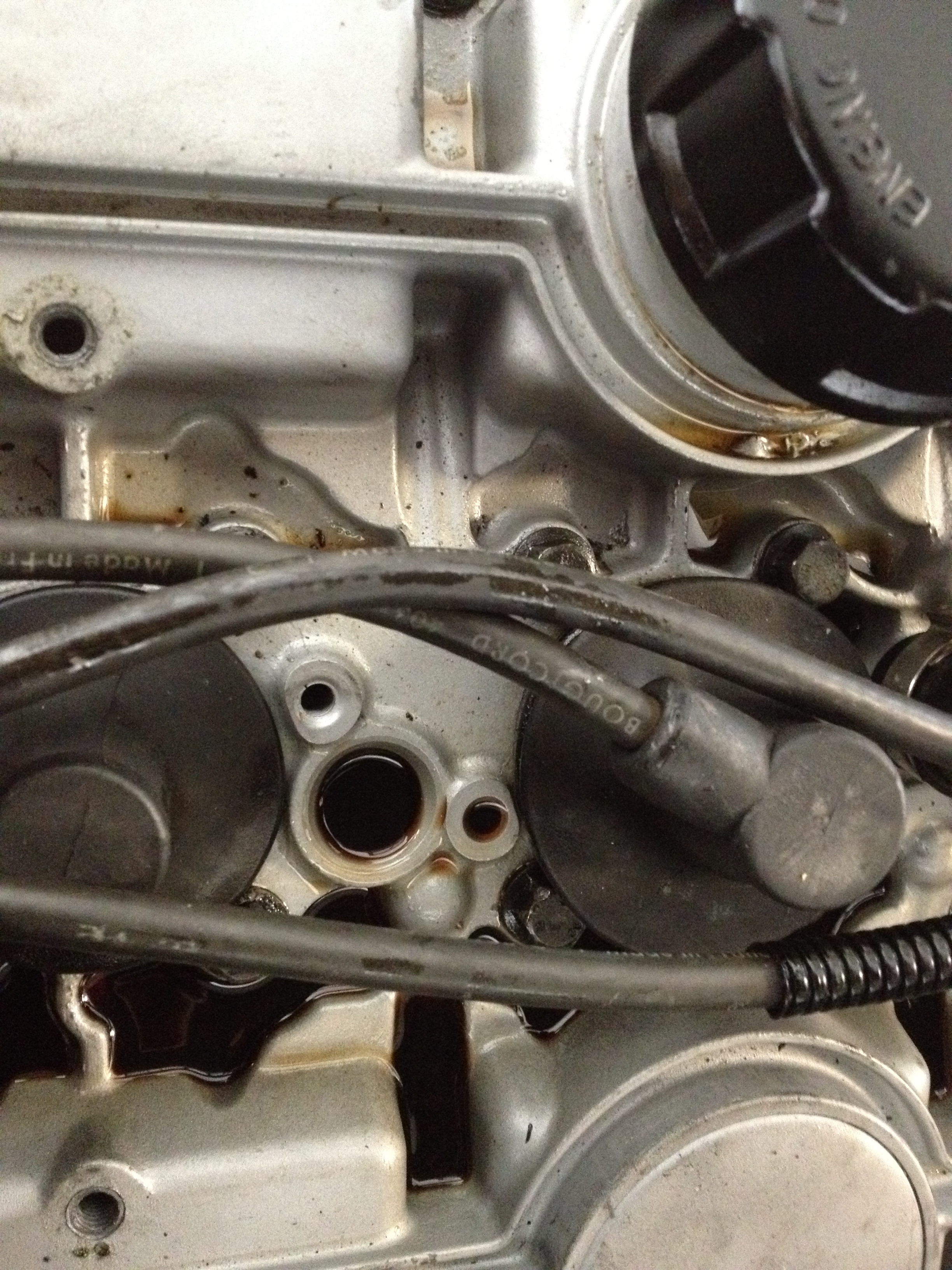

No. I also did the ballon trick to see how much pressure there is at the dipstick and it did not inflate the balloon. I also rebuilt the PCV system about 6 months ago. May have been URO brand though since I bought it from FCP. Need to verify since I heard these do not hold up. Here is a picture of the opening on top of the valve cover under the spark plug cover where the oil is coming from. It looks like something bolts on since there are two holes next to it. Any ideas?

There was another topic that mentioned this. I guess it is not supposed to be open. Are you sure it is a hole going through the valve cover? Maybe clean it up really well and fill it with some high temp silicone? I have no idea.

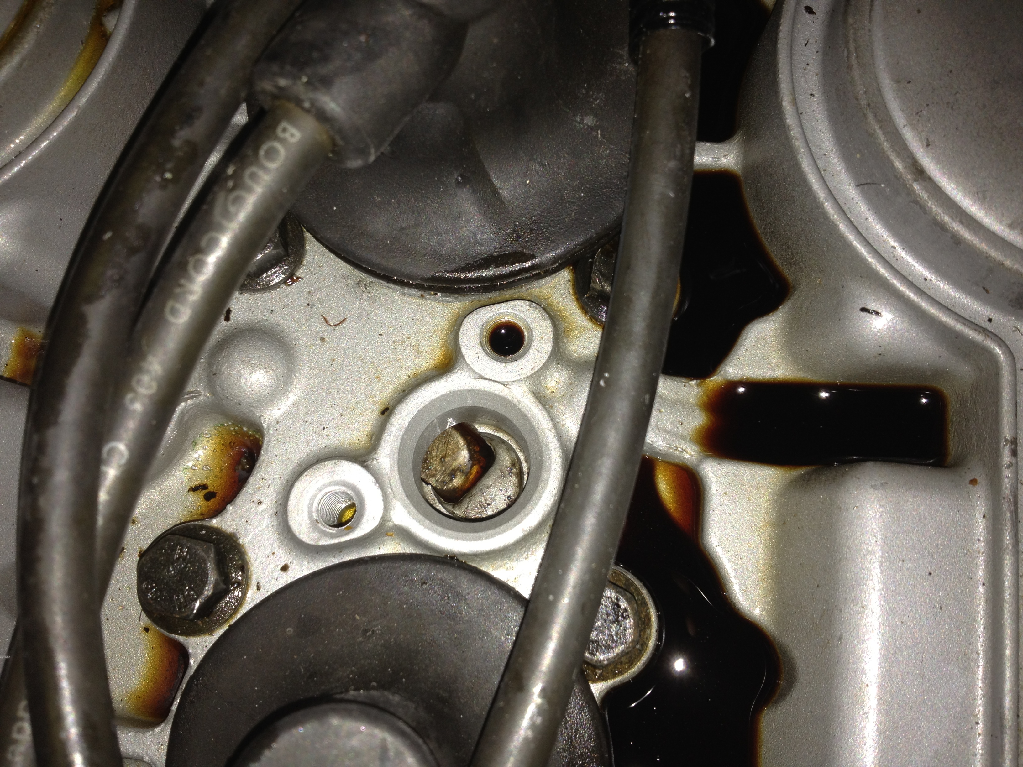

Yes it goes through the valve cover. I cleaned the oil out and there is a passage. Here is the photo. So what bolts on here? Am I missing a part? Wish I had the old head to see what was on it or if it even had this passage? Would a bad PCV system cause pressure to push oil up through this hole?

Epicsurf: From what I have been reading, I think that hole is normal. Other will weigh in on that. My idea for you oil problem could be bad PCV and or not a good sealing oil cap. Lot of dried oil around the cap area. It can leak and then run down to the bottom and fill up the hole you are talking about. Check hoses on top for hose clamps that are to tight and cut the line. (Don't ask me how I know that).
