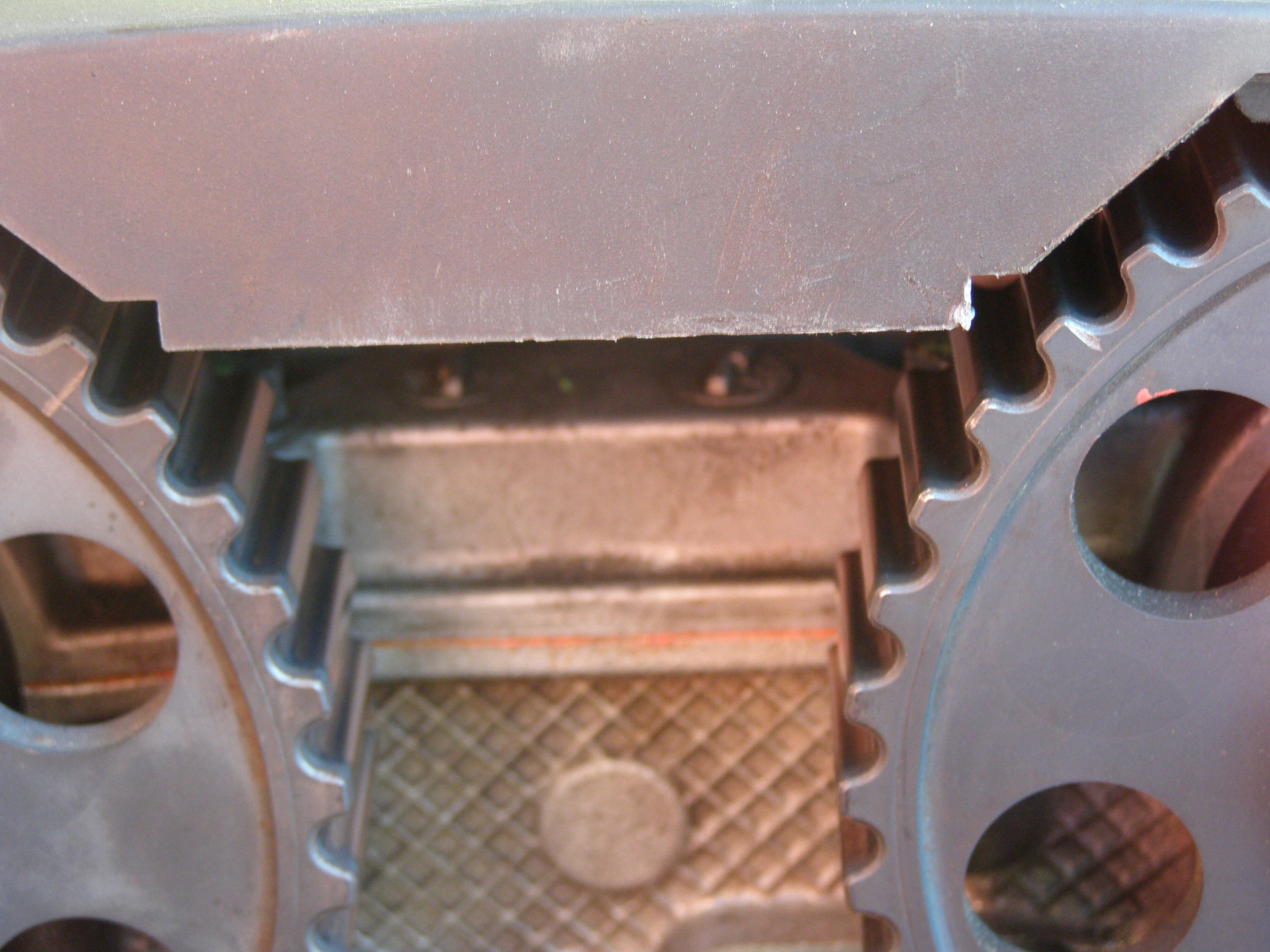

I took a shot of the cam marks. They look right to me but as you can see the intake is a little farther advanced than the exhaust. But after looking at it again I guess if I were off by one lug on the belt or one tooth it would be obvious.
So if this is how it's supposed to look, what about the guys who say they advance their gears by 1 or 2 teeth to improve performance? I take that to mean 1 or 2 teeth is not enough off of factory timing to be dangerous.
the old way of timing was to advance the timing till you could hear a knock ....then retard it a couple of degrees. That's where I got the idea that I might get rid of the slight knock by a one tooth adjustment.
Thanks again to you guys. Some of you sound like real fine fellers trying to keep an old carpenter from screwing up too badly. Like they say... a little knowledge is dangerous! That's me!

Your thinking on the marks is crystal clear. Those marks are good.
I did a timing belt job a couple days ago where the marks looked almost exactly like that when I pulled the old belt. I think that if the timing belt is really old it can actually stretch a little. Stretch on the tensioner side is taken up by the tensioner, but stretch between the sprockets has nowhere to go. So when you put the new one on, the intake cam may move back a hair counterclockwise. That's how it went for me on that job; the belt was original (16 years old) and had 92k on it.
When you adjust timing you move a few degrees, not a few teeth. Timing will run poorly if off by a tooth, maybe not at all if off by two teeth. The degree adjustments come from loosening the three bolts that fasten the sprockets to the camshafts.
