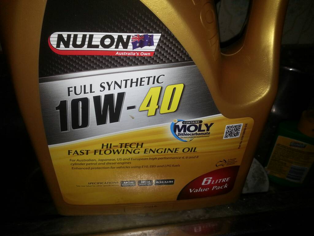

Replaced oil and filter and cap seal.
Kilometres:298, 823
Nulon synthetic 10w 40 and Bosch filter.
Cost: $65 (Supercheap Auto had a 20% off sale)
Kilometres:298, 823
