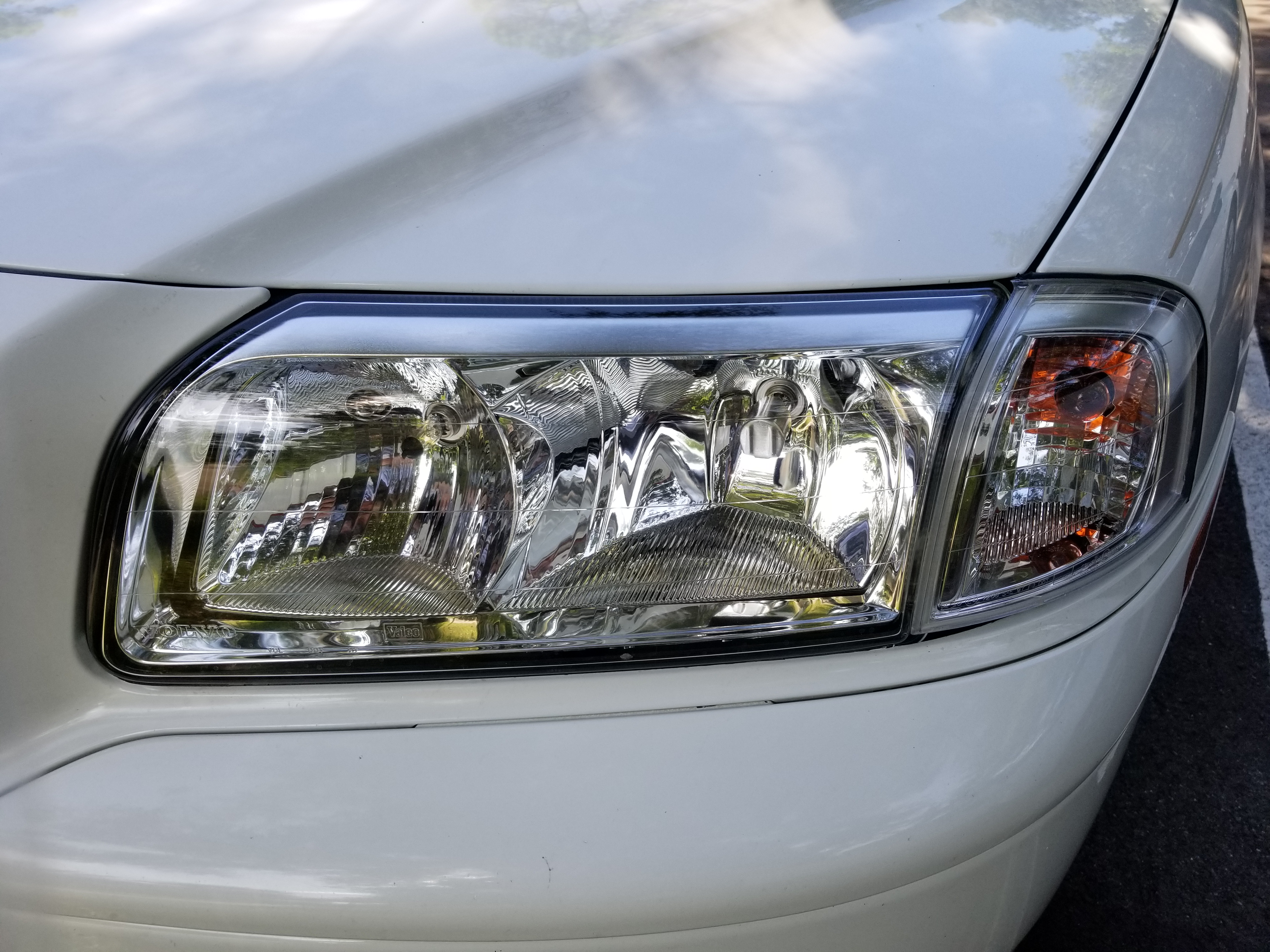

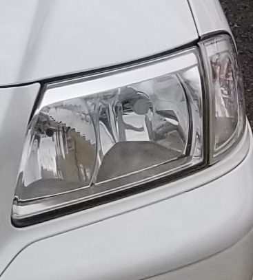

New headlights and turn signals installed today and Daytime Running lights are disabled. I wasn't taking no for a answer on the DRL and low and behold my mechanic found the menu to disable them and allow the light switch to actually work. I am really happy! Look at the sparkling difference between the burned up housings and the brand new Genuine Volvo replacements. June
