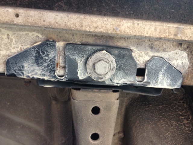

If you mean like the large hole visible in this pic, my car came from the factory with those holes on both sides but the brackets were still just about half disintegrated before this replacement (pic was taken yesterday, after replacement).
I am wondering if the area is just a really bad one for salt spray from winter roads.

My V70 brackets look different from those and there were no exposed holes in my bumper with bumper mounted to the bracket, so I drilled a drain hole in the bumper. Not only do I think it is a bad area for salt spray, when I had to change my bumper cover recently, you would not believe the sand/dirt/decaying leaves, etc. trapped between the bumper cover and bumper itself. That mass of dirt/organic matter acts like a big sponge and just holds moisture to the surface. I am a bit surprised the brackets are not better rustproofed or maybe even made of aluminum.
