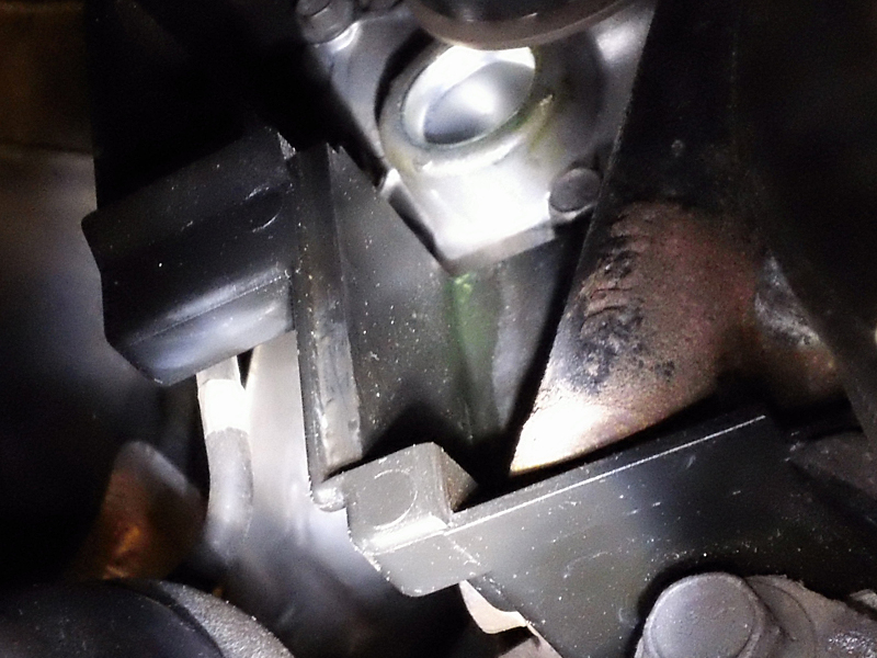

Ben850
Posts: 1613
Joined: 8 September 2011
Location: Michigan
Been thanked: 7 times
Post by Ben850 »
If the water pump was replaced in 2010, I wouldn't think the bearing would have gone already, but see if you could find a brand name stamped on it somewhere to possibly know the quality level.
Also, you may re-torque the water pump bolts to spec. I was at the scrap yard yesterday and after pulling a timing cover from a '94 850, I found one of the water pump bolts was about 1/16 of an inch out from being snug. the pump on that car looked to be a possible replacement as well, so you can never tell the level of attention that was paid by the last hands to touch the car.
Good luck.

Removed the TB cover, seeing from the below, there is a presence of coolant fluid.
corner with a trail of antifreeze...

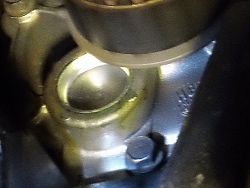

Brand HEPU.
a closeup
a closeup

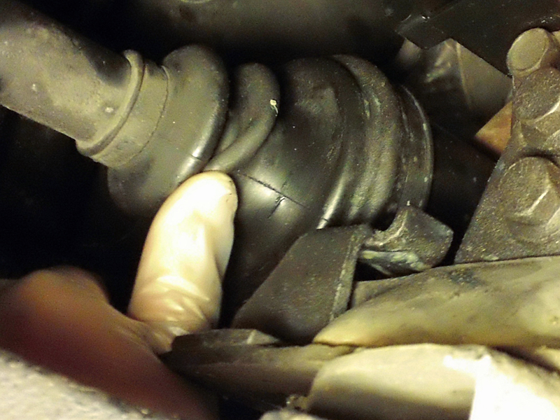

What triggered all this is a crack in CV boot which is leaking curd like grease. Found this slit, there may be more, but this is visible. These are sweat like, tiny drops around it.
a slit in CV boot
a slit in CV boot

CV boot or shaft is first unless you grab the water pump and feel loose motion. Seepage because the bearing is loose is a worry. A few drips with no other issues is not a worry. Many car manufacturers have info in their repair info on water pumps that have a few drips with no reports of needing to add coolant regularly is not an issue needing replacement. The silicates in coolant can dry up and the seal will have a leak path by lip of seal and the seeping effectively flushes the silicate deposit away and it seals again.
Don't go with the cheap CV axle assemblies. They have short lifespans. The pieces have little if any hardening.
