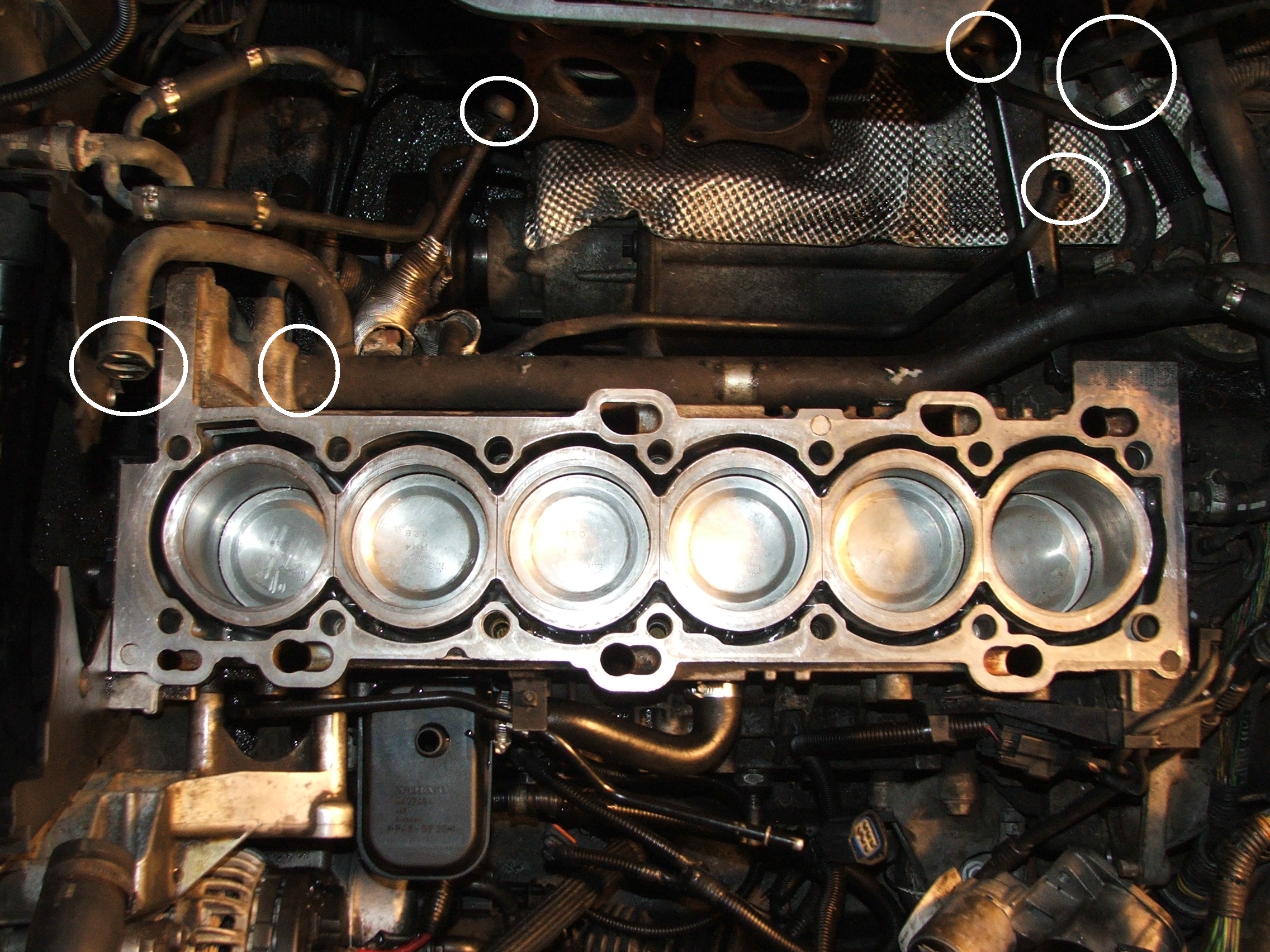

LOLzzzzz... Is that your pic?? well I had this pic when we were looking for the leak.. I had it on my phone for him to look at and see if we could figure it out.. Im going to circle the area we felt water coming out..

This is the area I can feel the water coming out...
- green is where I feel water near where the head meets the block..

nice circle.. huuh???

Yeah I just threw the pic together today with the rings. For sure video/pics from a phone is a great way to go. Saved my a$$ more than a few times! Found a massive oil leak in my S80 that only happened above 2500RPM... Busted $.50 turbo oil return line seal. I put my phone on the ground under the car, revved it and watched the video....
