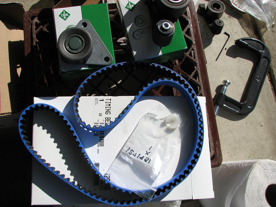

If you are talking about the Idler pulley, It shouldn't "spin" freely when turning it by hand. It should be a smooth rotation with a little drag to it.
If in fact you can spin it freely, it is probably your culprit. I just replaced mine and even the old pulleys were still stiff.
- new blue belt.jpg (102.7 KiB) Viewed 1335 times
