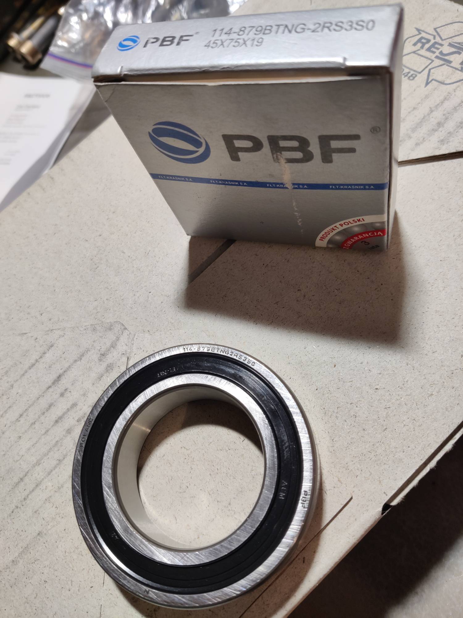

I've been trying to figure out how to replace this bearing too and could only find the 16mm version aswell. I did some more digging and managed to find the exact bearing thats originally on the cars, it's coded: 114-879-BTNG-2RS. Thought this might help some people so there's that

That seems correct as Volvo PN is 9181693.

Isnt part 9181693 a different one? For a lot of Volvos but not the p2's

Just received the bearing with the code I named earlier, this is the one right? Cost me €30,-
