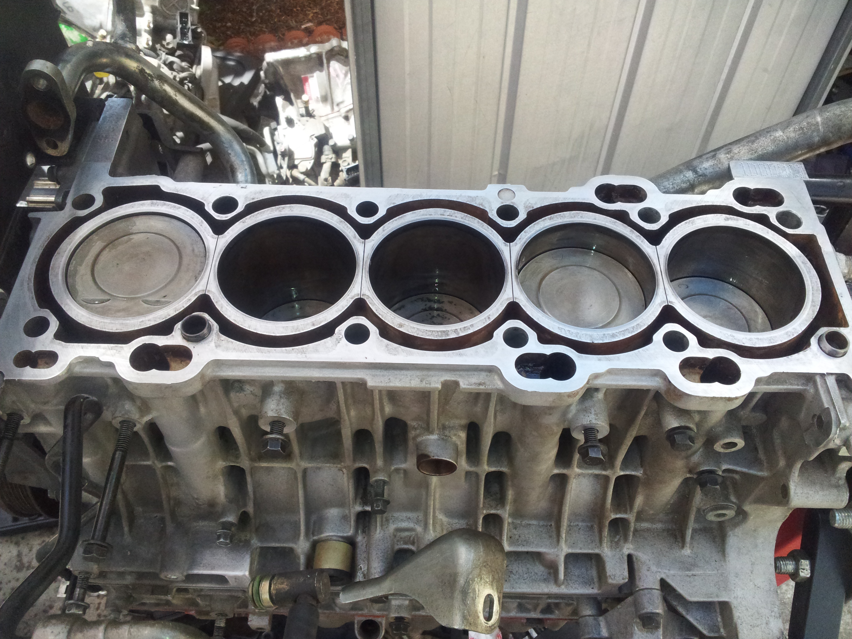

I too had a smoking dipstick (but not pressurised smoke) on my '99 NA V70 (now gone) after replacing the cylinder block with one from a 70K mile engine and thoroughly cleaning the rings with carby cleaner by lifting the cylinders repeatedly while spraying and soaking the piston tops then rotating the crank to loosen the debris. It was clean as a whistle when finished.
The compression was 195-205 psi BEFORE doing all this so I really didn't understand why I still got the smoking from the dipstick using new PCV and ensuring all ports were clear. There was no lip at all on cylinder bores.
It wasn't a high pressure output as on my high mileage 960 with VERY large lip on cylinder walls but smoke nonetheless.
