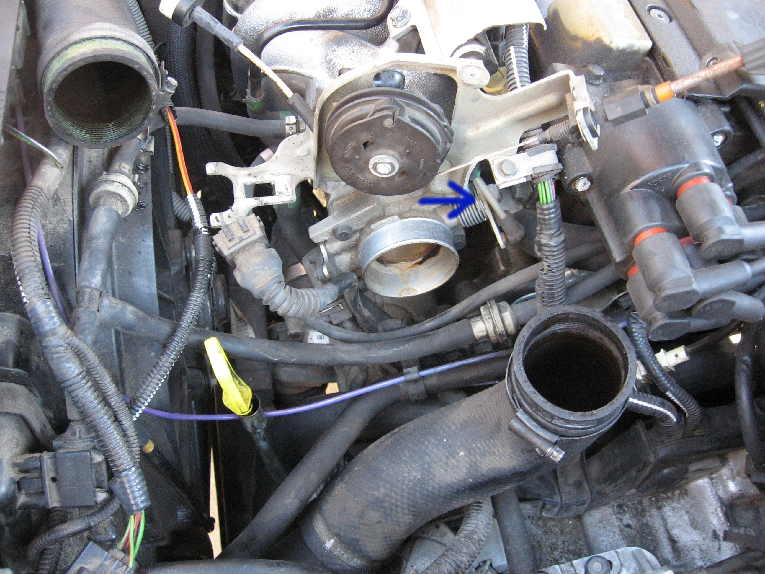

The throttle cable must be snagged on something.
Hold the triangle part of the throttle shown in the picture below against the idle screw adjustment - it must be touching. Loosen the cable at the bracket so this touches.
Replacing the cable took me about 15 minutes - not hard at all.
Throttle body is shown in my picture below as well, just after the idle air control valve.
