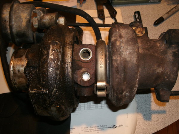

Take a real close look at the hole. I have a 15G that I'm getting ready to rebuild (I smell another writeup coming) and, as I look at the hole, it looks like it is possibly threaded. You might be able to put a threaded plug in that hole but I think it will need a shallow head so as to not interfere with the oil line that goes between the turbo and the exhaust manifold.
...Lee
