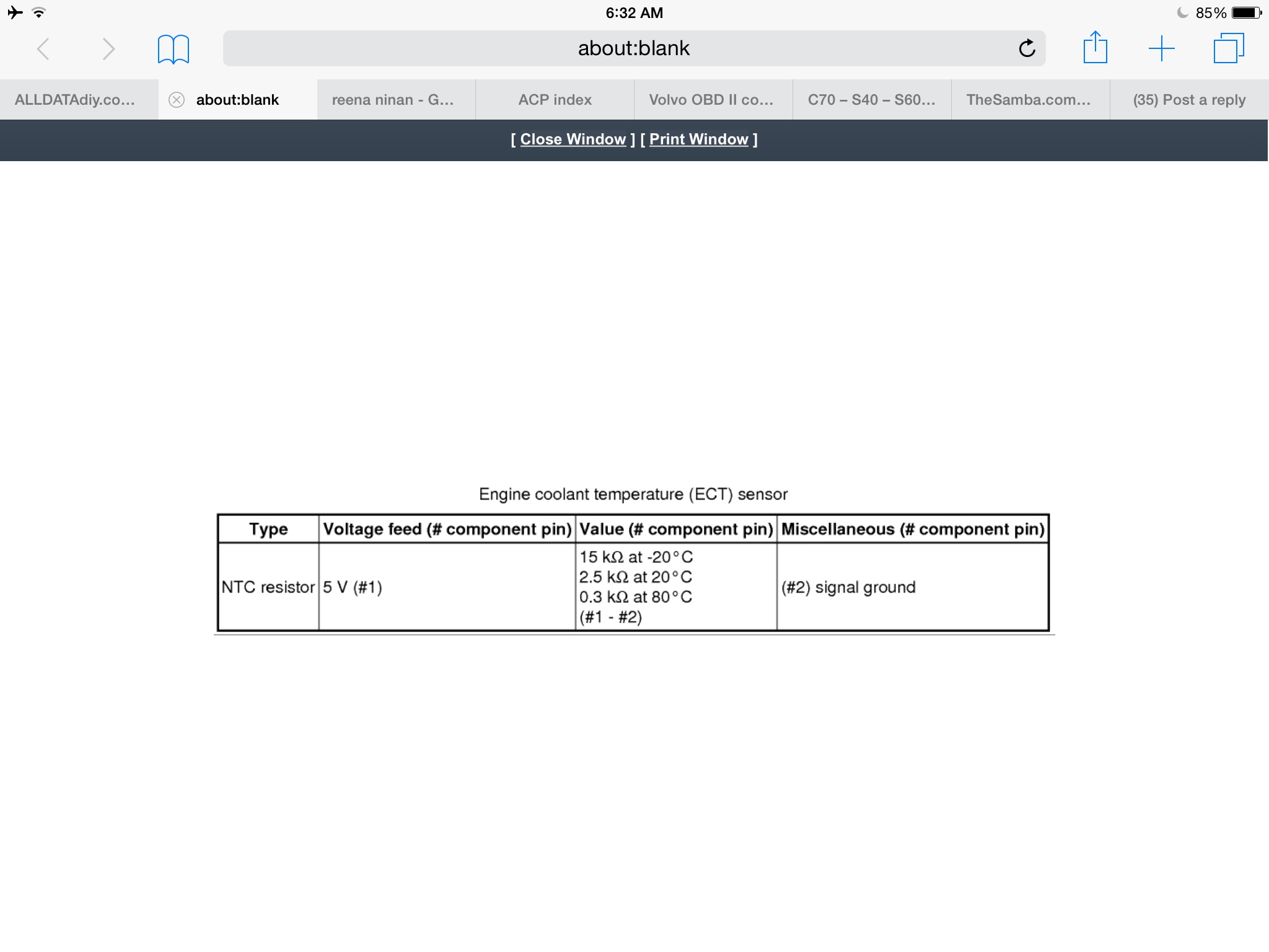

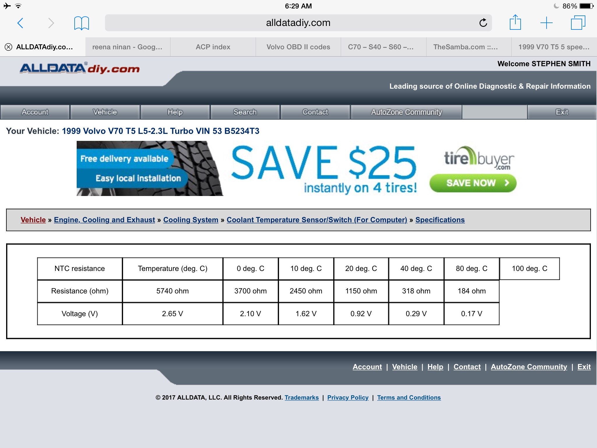

Engine coolant temperature sensor resistance chart for P80 and p2
Part 91866486 for P80
