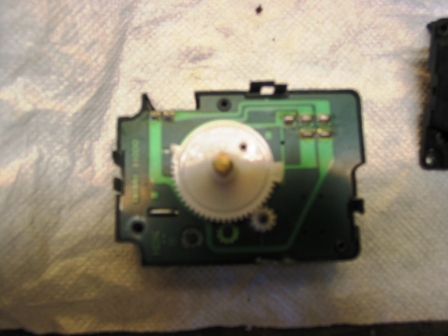

I took off the floor/defrost motor to check it out. All looks good. The vent was in the wide open position and the brushes under the white wheel look clean and good. There are 5 wires, 2 are 12V and move the motor back or forward depending on the polarity supplied by the ECC. The other 3 must be position sensors measuring resistance.
The stop limits are not electrical, per se, but physical. The white wheel driving the damper is capable of 180 degree movement, but the damper can only move 90 degrees. This movement is what is probably recorded in memory by resistance values. The picture is with the white wheel in the full defrost mode:
Floordefrost in closed pos.JPG (51.65 KiB) Viewed 698 times

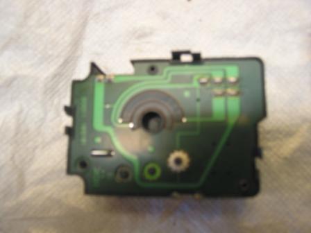

This is what you find under the gear wheel. The electric motor is under the board, top left. The 3 gold sensors travel in the black strip area

Dried grease was cought between 2 of the gold sensors under the gear wheel, inside the motor box. This was probably the "position sensor short to earth" error. Cleaned off with a soft toothbrush.
