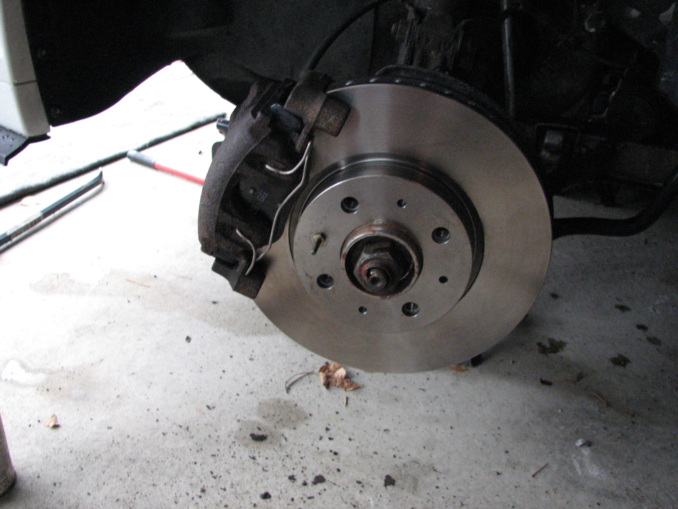

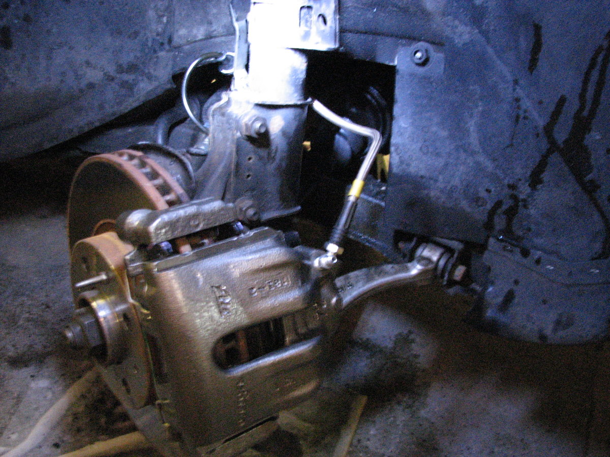

I have respect for the Akebono ceramic for the last year on the Sedan. I have already purchased a set duplicate front and rear for the wagon.
They will all come together with new Centric, drilled and slotted rotors. ( it sounds like overkill but I would like to know what the deal is) New rear calipers. A braided stainless line for the rear. I was surprised to find IPD stainless lines already installed in the front when I purchased the wagon.
I am driving the Sedan for the winter. The rotors are all new Brembo. Keeping in mind that '93 850s are four lug hubs. there is actually a surplus of these nice rotors since it is single year specific. Searching online I was able to find them reasonably priced.
I give a thumbs up to Akebono Ceramic. I am not a racecar driver, and don't play one on TV.(unpaid endorsement).
The calipers and pads are all the same in the 850 series.
I have nice rotors on the front of the wagon that I had salvaged. It will get its new drilled/slotted rotor and Akebono Ceramic pad treatment in the spring so I can bleed and break everything in according.
