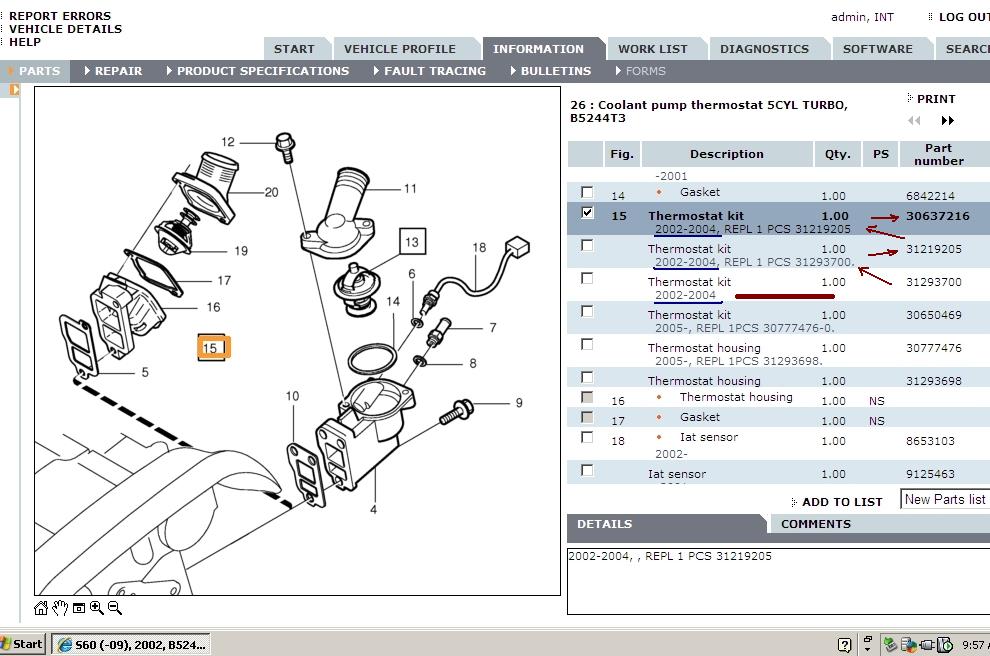

A look at the Vida page revels that ;
first
the picture doesn't match the part actually in the car!
second
part 31219205 REPL 30637216
part 31293700 REPL 31219205
.........................31293700
What does PEPL mean? Replace by or replaced by?
Now search on the internet is more confusing. Each number leads to sometimes totally different products.
BTW some European sites offer the actual thermostat I need (no housing) but they don't seem want to mail it to me here!!!
any help will be appreciated.
PS
I checked the data for 2003 models;
It is the same part numbers and sequence.
first
second
PS
Question (another one, I am abusing)
If engine number is the same "B5224T3" for both years 02 and 03 does it necessarily means same thermostat housing ?
- t-stat parts number.jpg (104.01 KiB) Viewed 3410 times

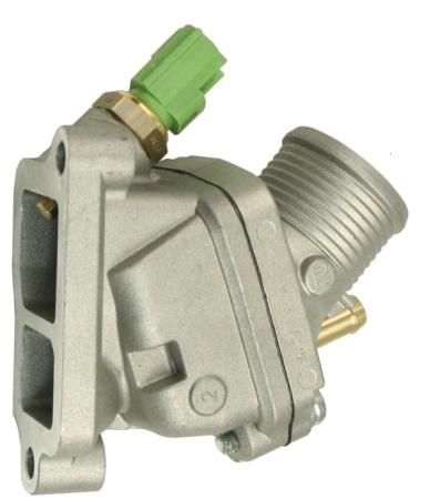

Is the t-stat housing in the picture the same as the one in your car? Mine it's different (2003 n/a) and the t-stat as well, it doesn't have the little bar on top of the pin.
If you mean [12] ? No, mine has a small 1/2" to 3/4" metal pipe extension about 1 to 1.5 " long.
Mine looks like this picture taken on the internet! (I took a picture of mine, it is too dark to see any detail)
The little pipe is under the main hose. It is there only for turbo engines, so it seems.
The thing on the top is the coolant temp sensor, I think.
- T-stat online.jpg (81.74 KiB) Viewed 3409 times

that's what mine looks like as well, without the hose because is non turbo.
I might be wrong, but I think all those are the same, with the turbo/non turbo difference.
Edit: you engine is a 2.3 or 2.4? Mine is 2.4

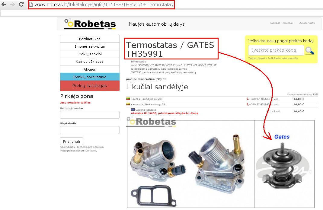

I have searched the web and Ebay in dept, unfortunately there seems to be no thermostat sold individually (as the one pictured), for some strange reason, because it can be replaced individually as any other thermostat. I'm afraid there is little chance for a mod that can be done to a regular thermostat to make it work in the housing, because the regular t-stats have a metal cover over the pin, while in this situation the pin is uncovered and sits against the housing. Side note, it seems Bmw also adopted a 'whole housing' concept in they cars around that era.
It is interesting to read the opening temperature in C stamped on the thermostat. It should match the one on the replacements, however I found the replacement (Beck$Arnley) to be two degrees lower than the original Volvo part.

@oragex,
I searched around, and it seems that Gates TH35991 may be the ticket.
Below is the UK diesel volvo forum but the tstat is the same I think (I maybe wrong though):
http://forums.t5d5.org/topic/25171-eiii ... m-up-time/

This website below seems to indicate that the Gates TH35991 works for many Volvo models (see list at the bottom of the page):
http://www.robetas.lt/lt/katalogas/info ... ermostatas
