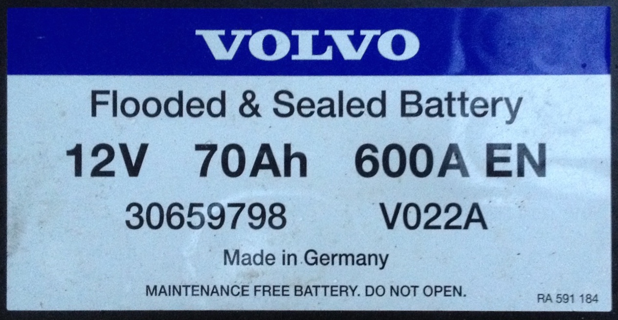

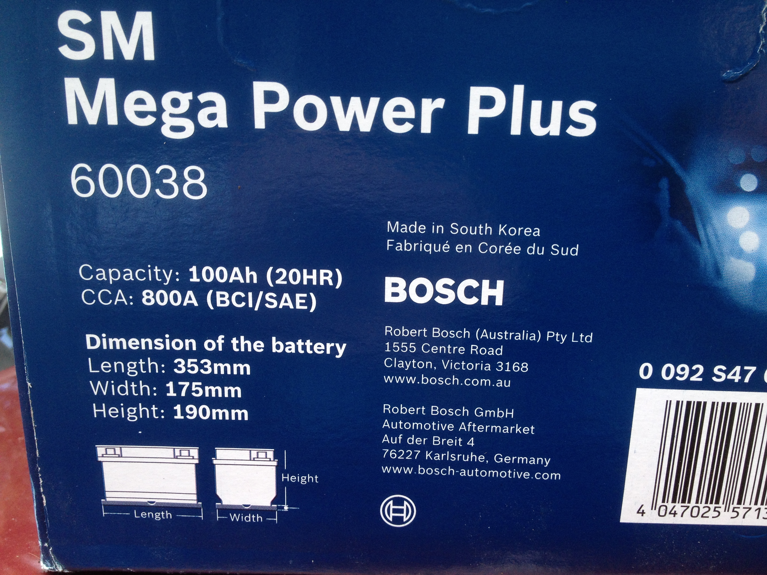

This might not be relevant to all but before you accept it might be the starter motor, just make sure you have the correct battery, as my situation turned out to be, just the wrong battery !!.
The trouble all started back in 2014 before I owned the car. The "from new" lady owner had it on lease from a Sydney Volvo dealership. From the Volvo service records in 2014 it appears that during a routine service the battery was changed. The first photo below shows this replacement batteries spec label. The second photo show my new one. I purchased the car in late 2015 and only after a few months noticed the poor starter response as previously talked about. I put it on overnight charge and it would work OK for a few more weeks then repeat the sluggish starting. This went on for a few more months of the same and so in frustration I finally replaced it with a new Bosh equivalent but it wasn't long before it started doing the same. During all this time I had taken it into my local indie but they drew a blank, my local Volvo dealership service centre who said it might be the starter motor but they would need it in for a day to really go through it (no thanks said I, it had already cost me $350 for a couple of hours just getting that opinion) and finally the local Bosh supplier who said that was the correct battery for that model so check connections and starter. At this point I had resigned myself to the fact it must be the SM and was just about to order a new one but decided to give it one more shot and try a local auto electrical mechanic from the phone book. Bingo, I hit the Jackpot, John was old school, a lateral thinker and within half an hour he had solved it. What no one had considered, with all their hi tech wizardry was the battery, it just wasn't powerful enough for a V8. So few XC 90's with V8 engines were imported into Aus that a major battery company had not even listed it, plenty of the smaller engine XC 90's, which my battery was for.
After a lot of communications between John and Bosh, they finally accepted their oversight and did a straight exchange at no extra charge, the second photo below shows the specs for the correct battery now fitted
I am assuming the new Volvo battery fitted in 2014 was just another blunder by a Volvo mechanic. I wonder what size was in it when first purchased in 2008, were batteries fitted at factory before shipping or was it up to the destination country to organise this.
Anyway, I am now very happy with a perfectly starting V8
