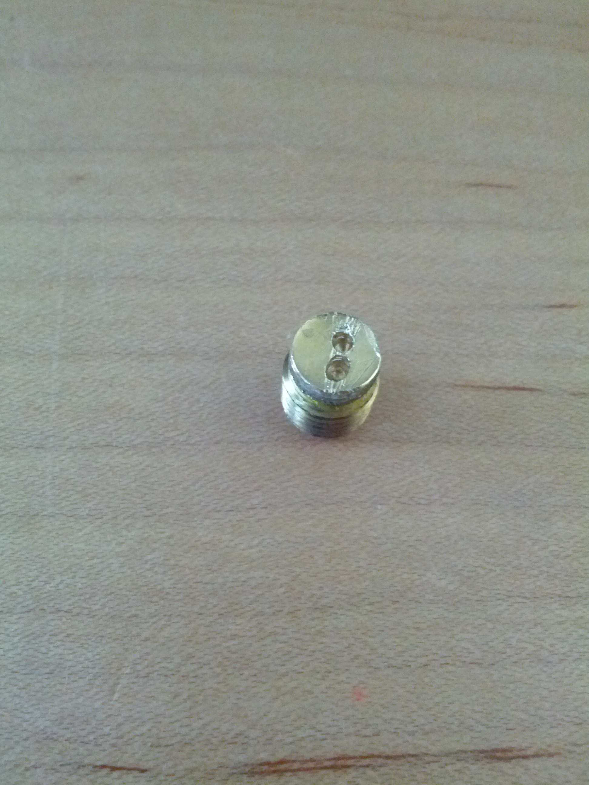

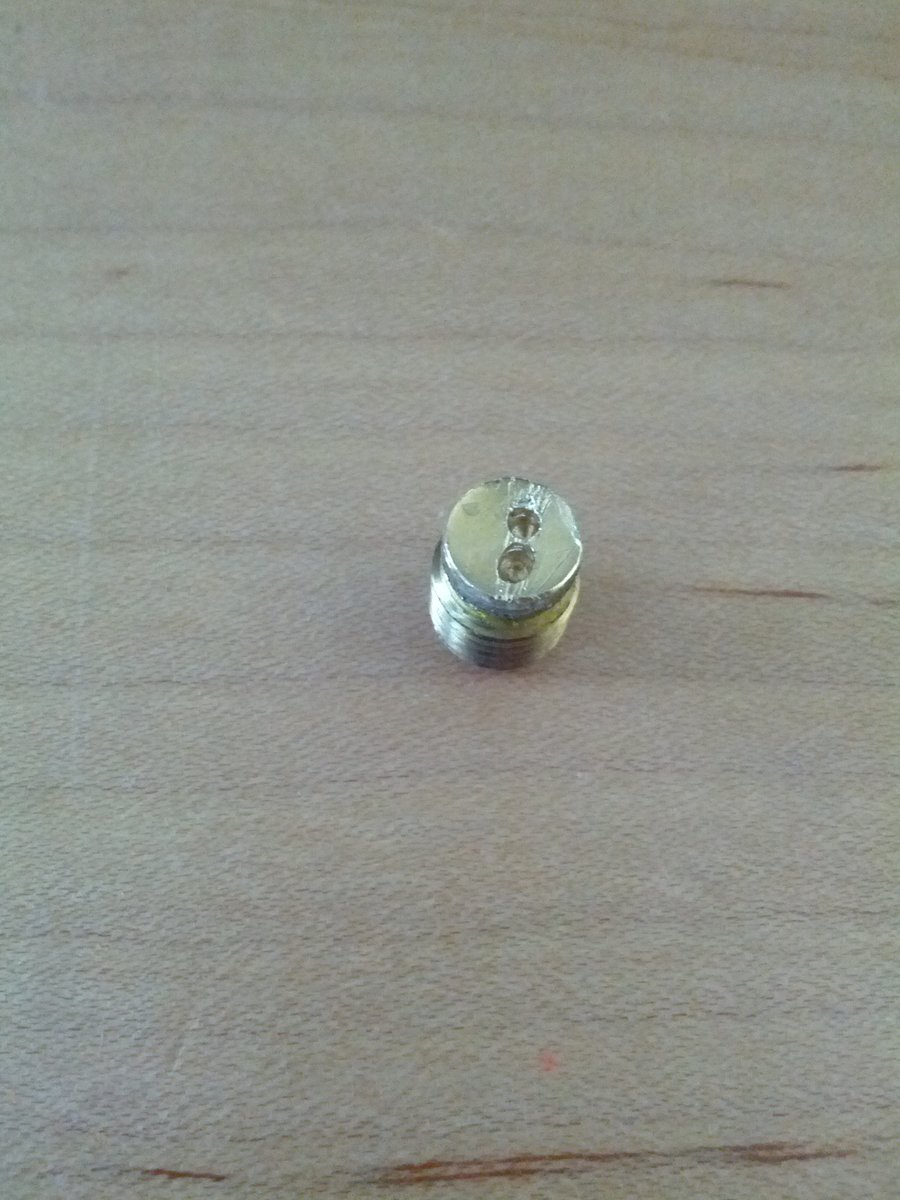

Hey guys, here's my final update for this situation. This morning I went out to get the darn bolt out (On the top of my university's parking garage). I drilled two very small holes in the top of the bolt and used a security bit to get it out. It was barely screwed in, and came right out! Of course when I went to fill the system, the charge set I coincidentally got on this day last year started to leak as soon as I attached the can. A few weeks ago, the compressor clutch would engage but shut off quickly, and after this, it doesn't even engage at all. I'll have to go out and get another - hopefully the system will hold a charge for the nasty summers here in Cleveland.
