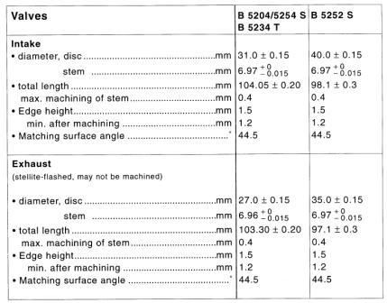

rspi wrote:When the shop gets the head, they will check all of the cylinders. There is NO reason to have other valves replaced, just the burnt one (or pair). If they rebuild the head, new stem seals, they will regrind all of the seats and valves to make sure they are in near new condition.
Have that cylinder injector tested and cleaned professionally.
One reason to replace exhaust valves - Stellite coating! Those are not supposed to be ground as the coating goes away.
There will be a loss of long term durability with uncoated valves, i.e. if someone grinds the exhaust valves. Does that matter on an old car? It depends how long you will own it!
rspi

northernlights wrote: One reason to replace exhaust valves - Stellite coating! Those are not supposed to be ground as the coating goes away.
Interesting... So this "coating" doesn't wear off over time? I was told that valves wear over time, as they are spinning in the head. One of the main reasons they burn, wear???
northernlights
Posts: 251
Joined: 12 October 2012
Year and Model: 850 Turbo 1994
Location: Florida and/or Raleigh NC, depending on the day
Been thanked: 8 times
Post by northernlights »
I'm sure it wears, just very slowly. The coating significantly increases the durability at elevated temperatures. It's only on the exhaust valves, but notice they seem to be the only ones to burn...
There was a time not too long ago when it wasn't unusual for an engine to need the valves and seats ground after 30-50k miles. Technologies like Stellite coating helped to fix that problem.
