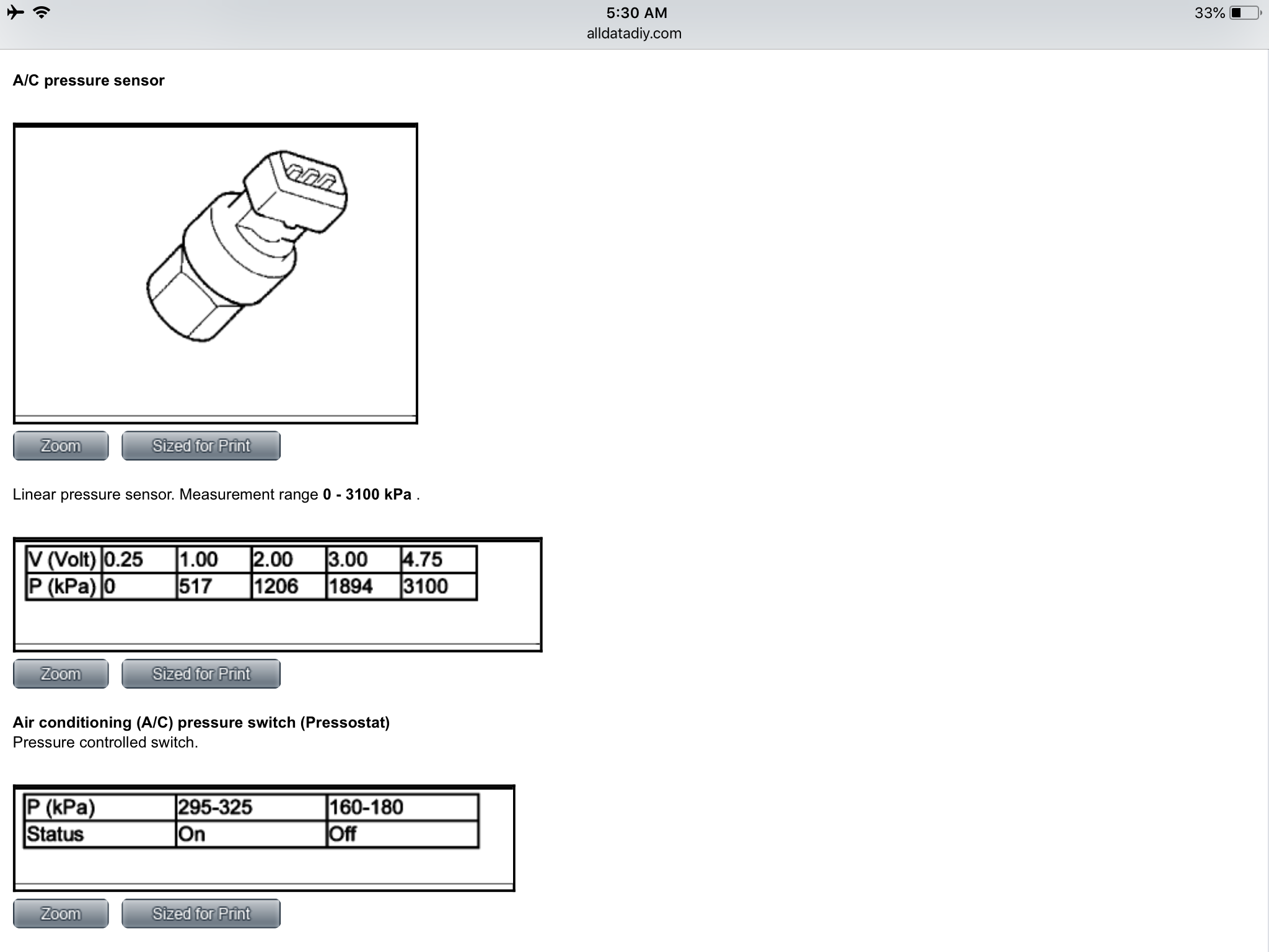

This is a 1998 1999 2000 MY part. Terminal 1 is ground through ECU, measure voltage on harness on terminals 2 and 3 with harness disconnected. One of them will be 5 V, the other will be the one to check resistance in the switch between that pin and pin 1
Resistance soecs per chart
Does anybody have corresponding resistance values measured of a working sensor. Im getting 20kohm. fol-fcr is showing pressure somwhere 2400kPa which is obviously too much. Engine TDC is showing code EFI-225 Air conditioning pressure sensor signal.
As a remark, i have three non working sensors, two of them show 20kohm, one shows 40kohm.

I can measure on my 99 if you tell me which pins you want measured
