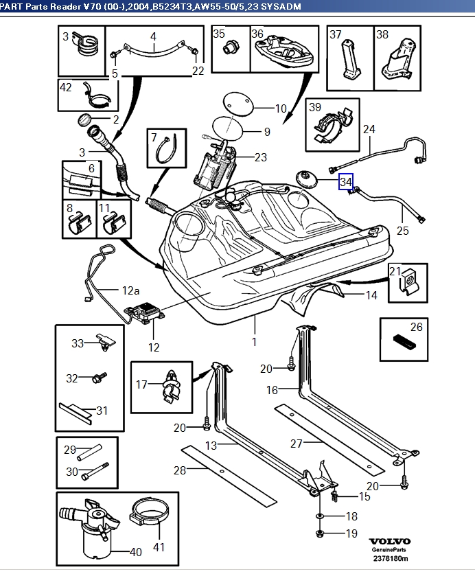

May I suggest you check the wiring regarding the pump AND the controls (level sensor etc)
I have a S60 with a different tank-pump-level sensor. The same problem happened to me. After a LOT of time spent searching everything on the car I found out the the point of contact between the wires and the level sensor was burned out. Sometimes there was juice sometimes there wasn't.
I had to replace the level sensor.
It may be worth checking before buying something
This must be your system, I have my level sensor at # 35 on this picture.
