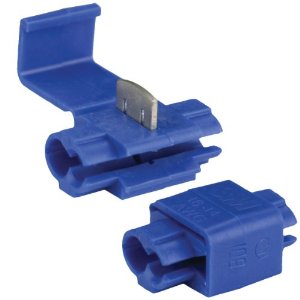

I used these and bypassed the whole crumbled connector. 15k miles, 8 months, and it is holding up fine.

What is that? Did you just crimp the wires together in there and bypass the harnesses all together?

mindshadow wrote:What is that? Did you just crimp the wires together in there and bypass the harnesses all together?
They are called "Scotchlok"s. You can buy them at Walmart.
Yep that's exactly what I did

Nice. So how much exposed wire do you need? Just enough to tie them together, then slide that thing over and put the crimp down? I left my long extension cord somewhere else, so soldering is a bit difficult for me right now. :(
