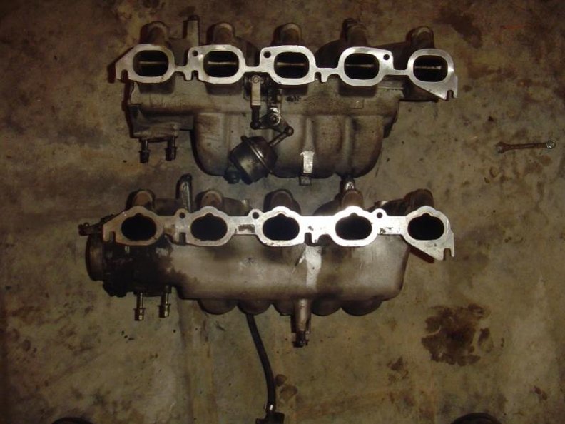

I think this photo credits to Ben850. Look at the intake manifold, if it has that funny actuator underneath then the car has VVIS:
As for what VVIS does, I am not qualified to chime in. Some people do really like it, I remember a long thread about somebody adding VVIS to a later model vehicle that came without it, but my impression was VVIS is more trouble than it is worth. I do know Volvo got rid of it during the 94 production run ...
