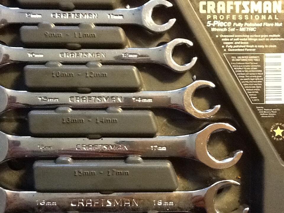

kahl
Posts: 943
Joined: 27 October 2012
Year and Model: 2000V70XC
Location: columbus ohio
Been thanked: 10 times
Post by kahl »
This is first of 5 cars that I could not get the nut off. I have the Craftsmen flare nut kit in both SAE and metric. Both sets have oversized surface grip areas. I first cleaned coupling with brake cleaner then put heat on the flex hose nut. So 1 in 10 nuts could be a problem. The reflaring was no big deal after I got over the WTF freak out psychological brain melt episode. The other side came off with no problem.
Metric kit
Metric kit
dosbricks
Posts: 1116
Joined: 30 December 2004
Year and Model: '96 855, '98 S70
Location: South Texas
Been thanked: 2 times
Post by dosbricks »
I have some Craftsman box ends which drive me crazy when they omit a size or jump it to the next wrench. I'm thinking of putting them in a garage sale and getting a larger set of HF wrenches that are sized more intuitively.
