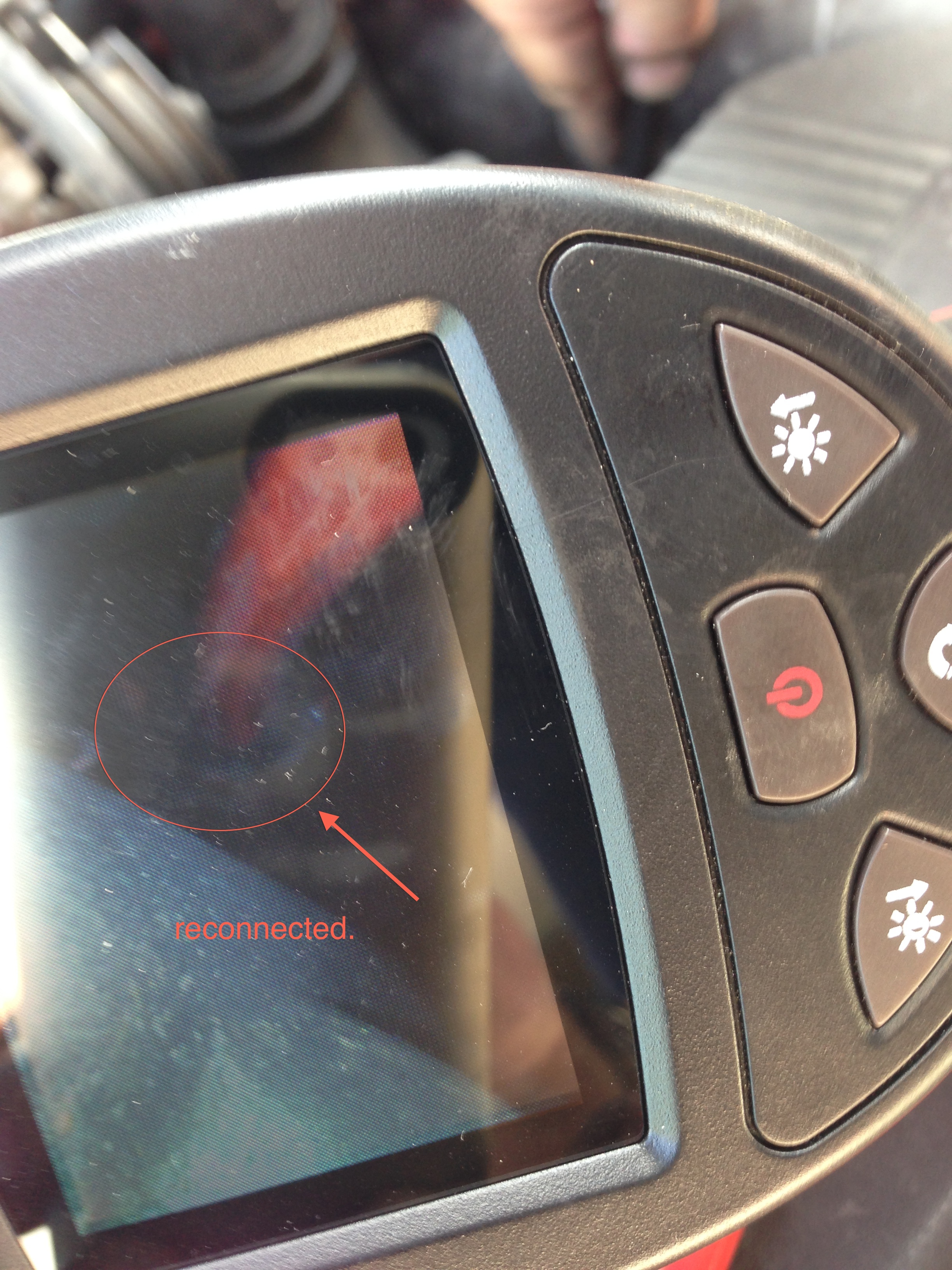

Wow, easier than I thought. Boy, ya gotta get'cha one of these HarbourFreight bore Scopes.
Re-connected, I'm done. Fixed. Thanks for all the help.

The P0442 small evap leak code came back.

Found vac hose off again. must'a knocked it off last time under hood. fixed-again.

Next time P0422 comes back...
check the hose again..
Glad you slayed the dragon..

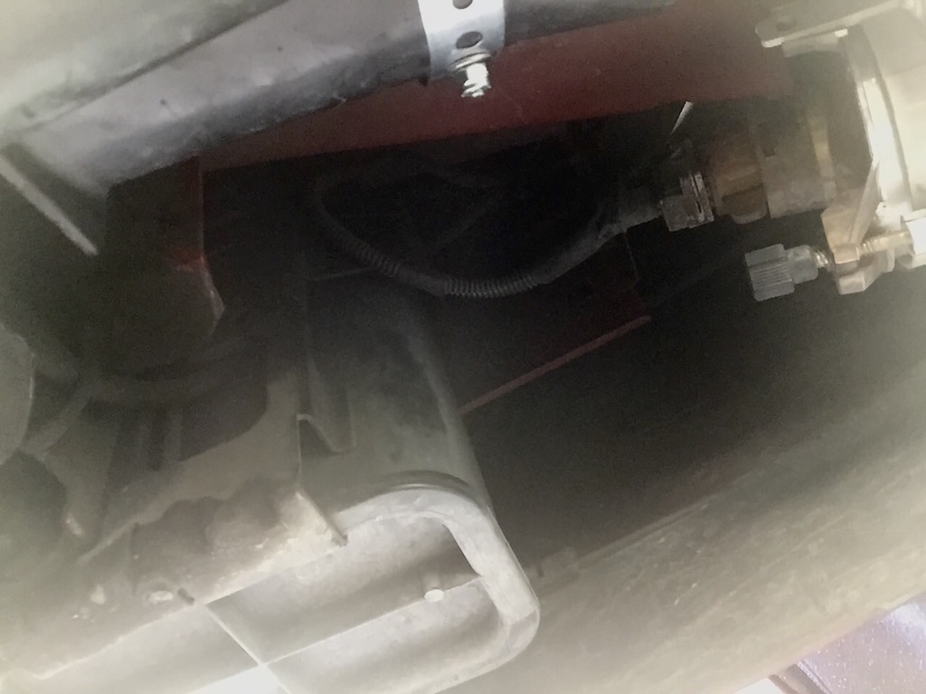

OK, dumb question. Most posts says the evap canister is in front of the rear passenger tire or I have seen some say it's by the gas tank.jblackburn wrote:V70 AWD - canister is at the front of the car, tucked inside the bumper in front of the drivers side tire. Pull it down and have a look at the hoses on top of the canister. If it's not cracked there, follow the hose back to the gas tank area.
Ramps would be advisable
You have indicated that it's behind the bumper on the driver's side. So I have a 98 V70 T5 (not AWD). I'm thinking mine is where yours is located. Here's a picture. Is this the evap canister on the lower left? Note that the thing on the upper right is the back of the foglamp in the front bumper on the driver's side. It looks like it's held in place by a bracket with one bolt. Sound good?

That's it,,,that black rectangular box on the left of your pic.
In 1999, it moved to the back pass rear wheel (US models)

Great, thanks for the confirmation.abscate wrote:That's it,,,that black rectangular box on the left of your pic.
I dropped it the other day and took a look at the 3 hoses going into. My hoses appeared to be in pretty good shape and there was no damage that I could see. Sigh, I think I'm going to need to get a smoke test or something to find my P0455. I've already tried the easy stuff (Gas cap, purge valve).
So it goes.

I don't know if the '98 AWD V70 style has the roll-over valve near the fuel filter, but if it does and you haven't checked it, I would recommend inspecting the two rubber hoses that connect that valve to the hard lines. On my '97 855 those hoses were damaged and when I replaced them my P0455 code was resolved for several years (before coming back again due to a failed Evap purge valve -- also replaced).
