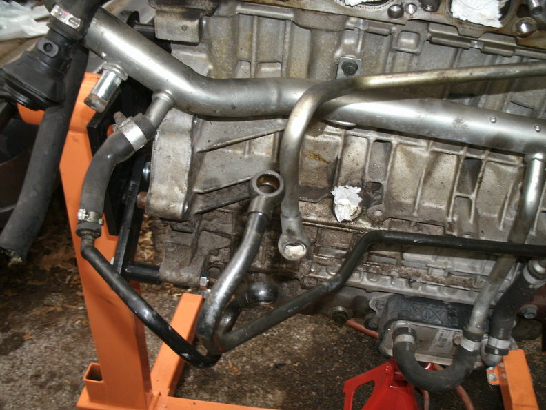

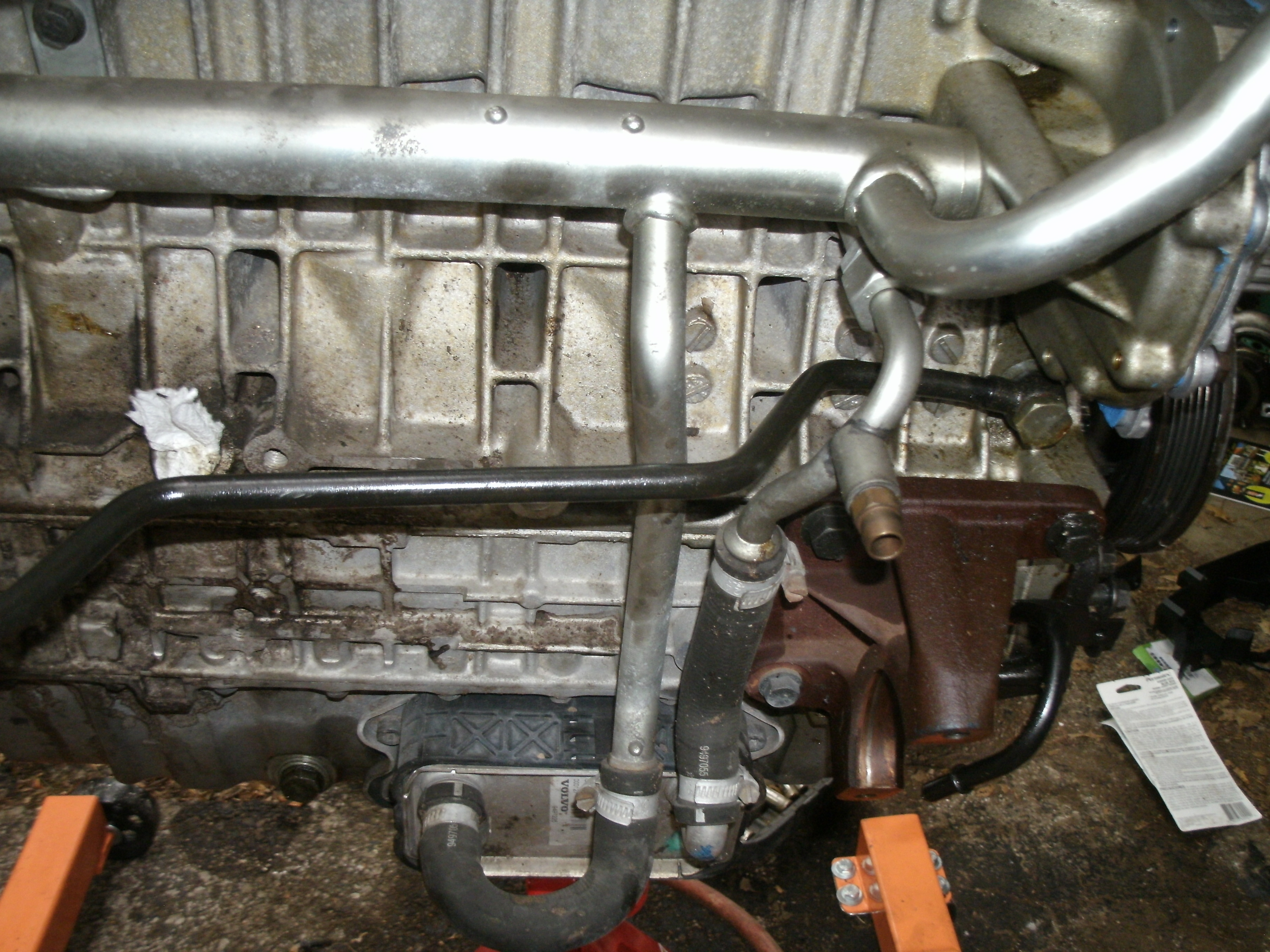

Ozark Lee
- Posts: 14798
- Joined: 07 Sep 2006, 08:24
- Year and Model: Many Volvos
- Location: USA Midwest
- Been thanked: 76 times
It goes to a socket on the block that isn't there.
The oil supply is pictured here (the banjo bolt):
The return socket is more or less pictured here:
The socket in the picture has a paper towel shoved in it.
...Lee
...Lee
