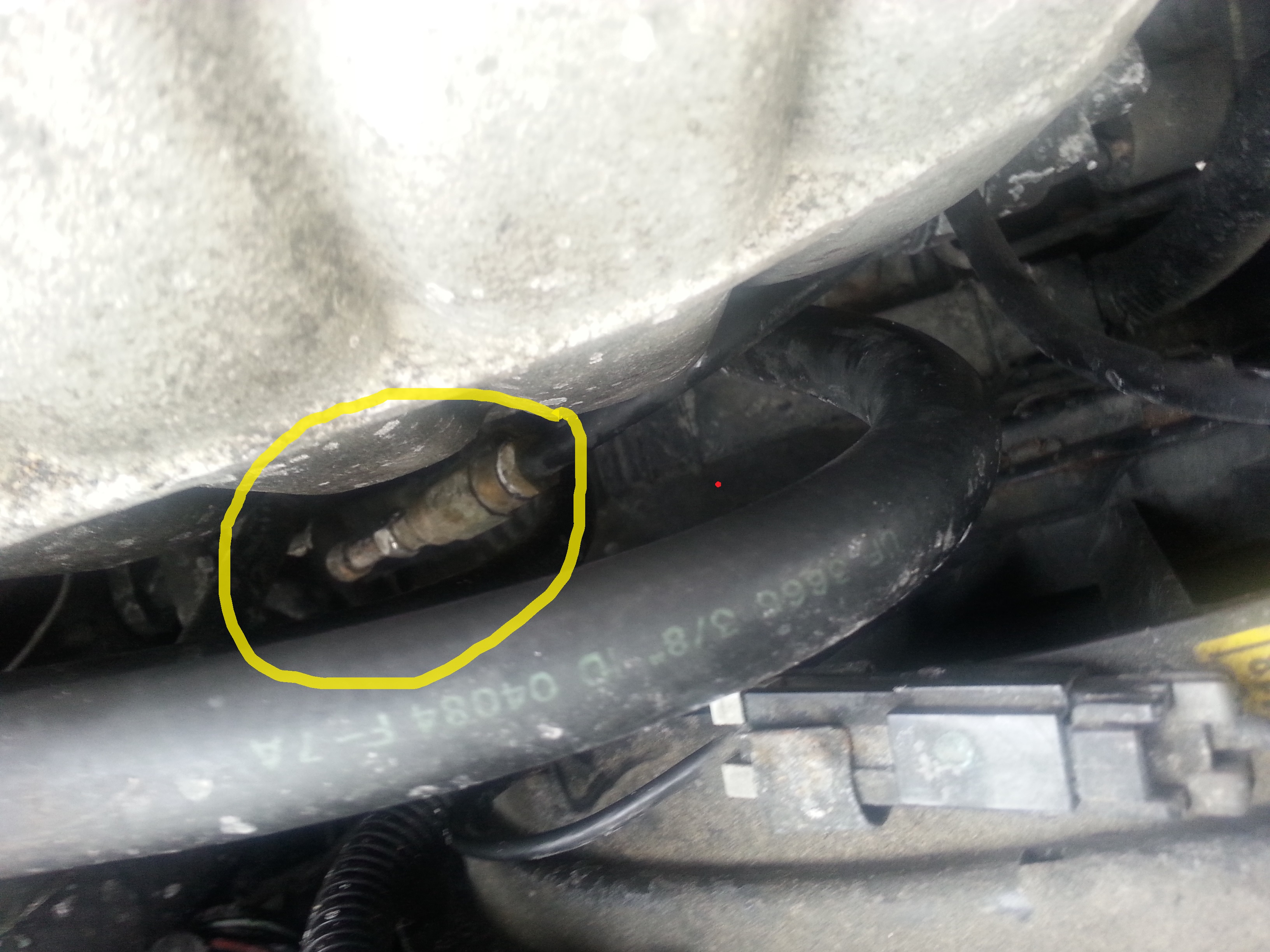

I have absolutely no idea what is going on there. What is the heater hose behind the fan? Where does it go?
What you are showing there doesn't look like anything associated with the fuel pressure regulator. The regulator is on the fuel rail and its vacuum line should go to the tree.
...Lee
...Lee
