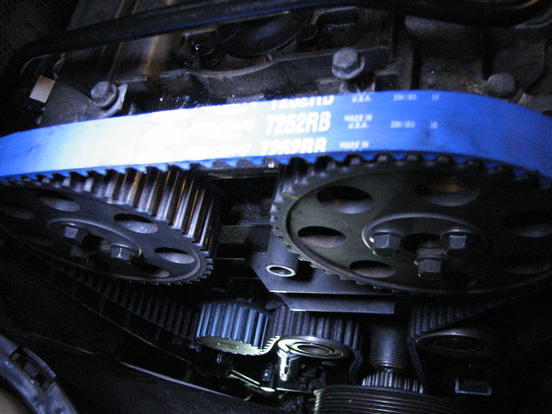

Ben850
Posts: 1613
Joined: 08 Sep 2011, 13:53
Location: Michigan
Been thanked: 7 times
Post by Ben850 »
Well, if you do them both at the same time, you can attribute the hours to the more laborious part.
Honestly, I couldn't decide what to charge myself.
For the wagon.
For the wagon.
I had to wait for the water pump delivery to install the timing belt.
It all seems better for the hours.
This was over a four day period, but while access was there, Timing belt was an hour. With Water pump and pulleys.
PCV was completed in steps as re assembly went on, so allocation of hours is irrelevant on this one.

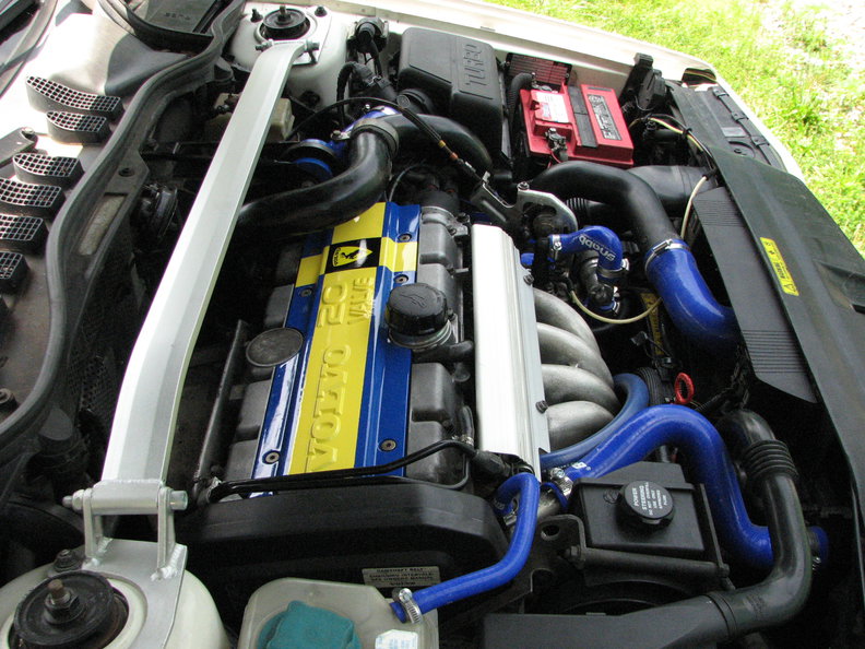

My sedan was the first. It took a full day of replacing burnt and/or broken vacuum lines before I could bolt on the intake manifold.
If your '93 was abused more than this rescue, I would be surprised.

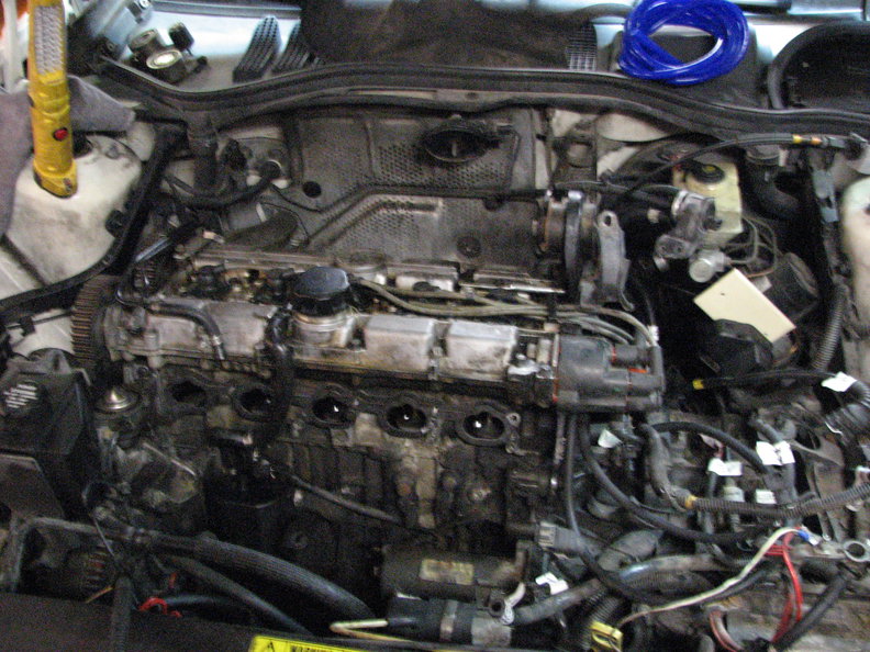

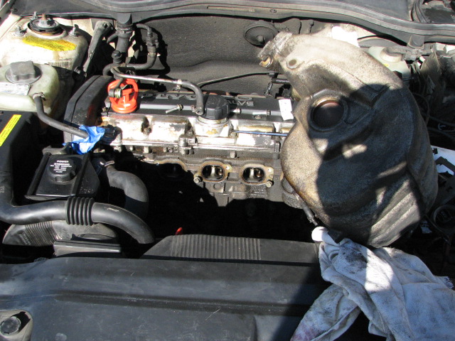

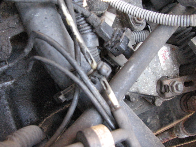

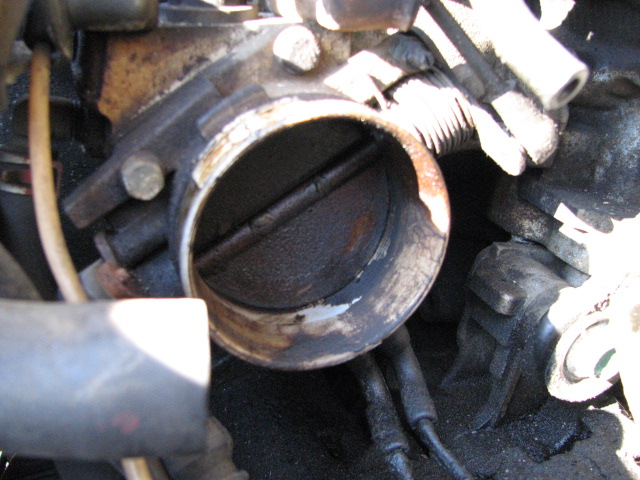

I had forgotten the photos of my new experience.
Kind of yucky.
Kind of yucky.
It was a genuinely happy 1993 850 GLT at that point.
The Alter I became forever Altered.
Hey, I hope you enjoy the Photos, owning a '93 feel free to ask. I have been through every nut and bolt.
The resurrection to an Altered story is here.
https://www.matthewsvolvosite.com/forums ... 35&t=47157

The only part in my installations that was not OEM was the Gates Blue Racing belt, of which I have no problem.
Aisin pump, as pictured. Aisin hydraulic tensioner. INA pulleys.
