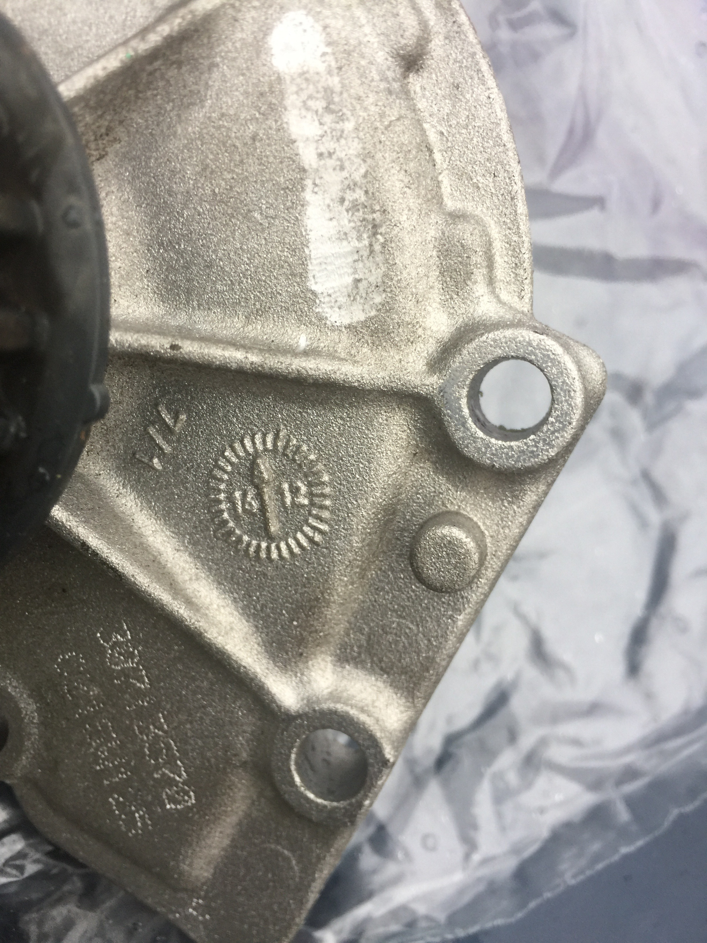

I saw your video on youtube which got me thinking about checking for the date stamp. My TB looks newish and the pump looks brand new so I went looking for the date stamp. As you can see my date stamp looks different than your AISIN pump in the video. My guess is the top number is the year and the bottom number is the month. Just checking to see if anyone can verify that assumption.

mecheng… I am not afraid the change the pump once I get in there. What I am really after is getting a feel for when the timing belt was done. If I can verify that the water pump is from 2012 then I'm not going to worry about the belt until I get to 140,000 miles so I can be on schedule. I can look at the car fax and determine that the car had about 102k on it in april of 2012. If the pump was done in 4/12 then the belt was certainly done then as well. It's definitely not an original belt.

I had a look at my wp: it has 81 / 07
81 on top and 07 on bottom. So I'm not sure how to read the date codes

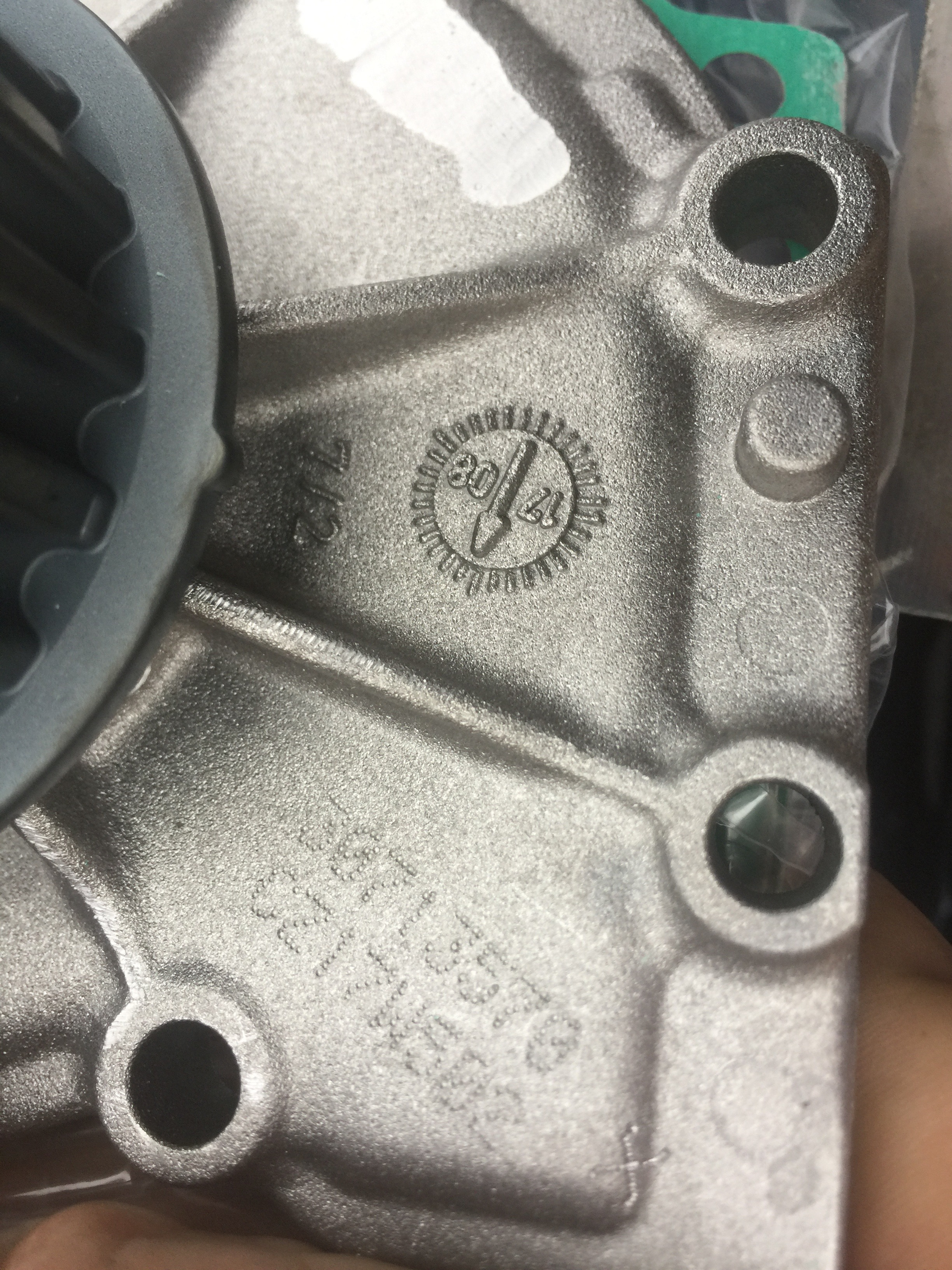

- Posts: 36137
- Been thanked: 4063 times
I’ll snap pictures of two pumps I have and post - from the purchase history I can say these are dated YY MM
These are both AISIN, with the Volvo Metal casting machined off.
