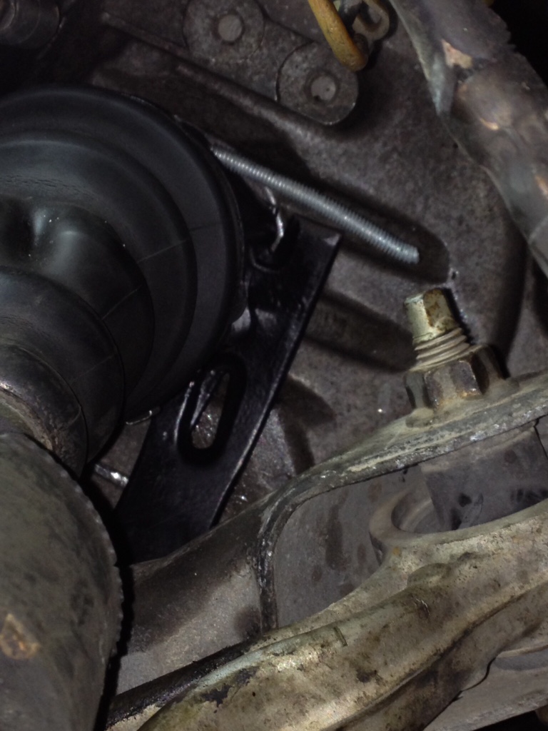

So I put the passenger side back together, then jacked up just the one side of the car hoping the transmission wouldn't move as much when I was trying to hammer the pry bar in or maybe the other axle being in would put some kind of different pressure on the transmission - it probably doesn't look like a lot but compared to the pry bar refusing to go in at all before it seems like a lot of progress - but it still didn't come out...
I'm going to try to have someone else help pry from one side while I pry from the other tomorrow... So *hopefully* that does it...
