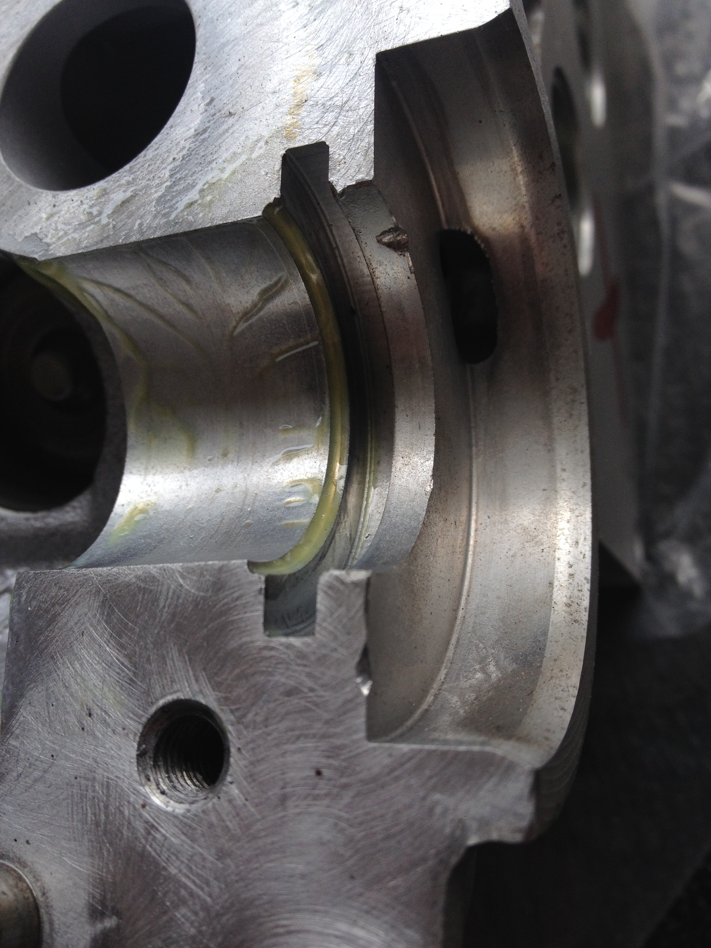

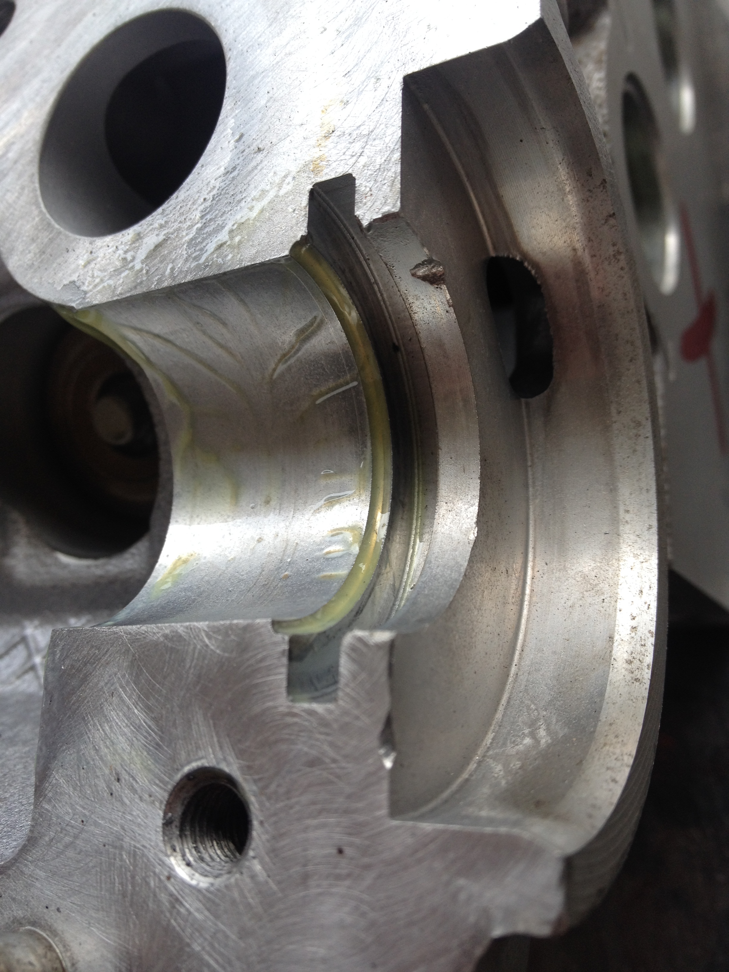

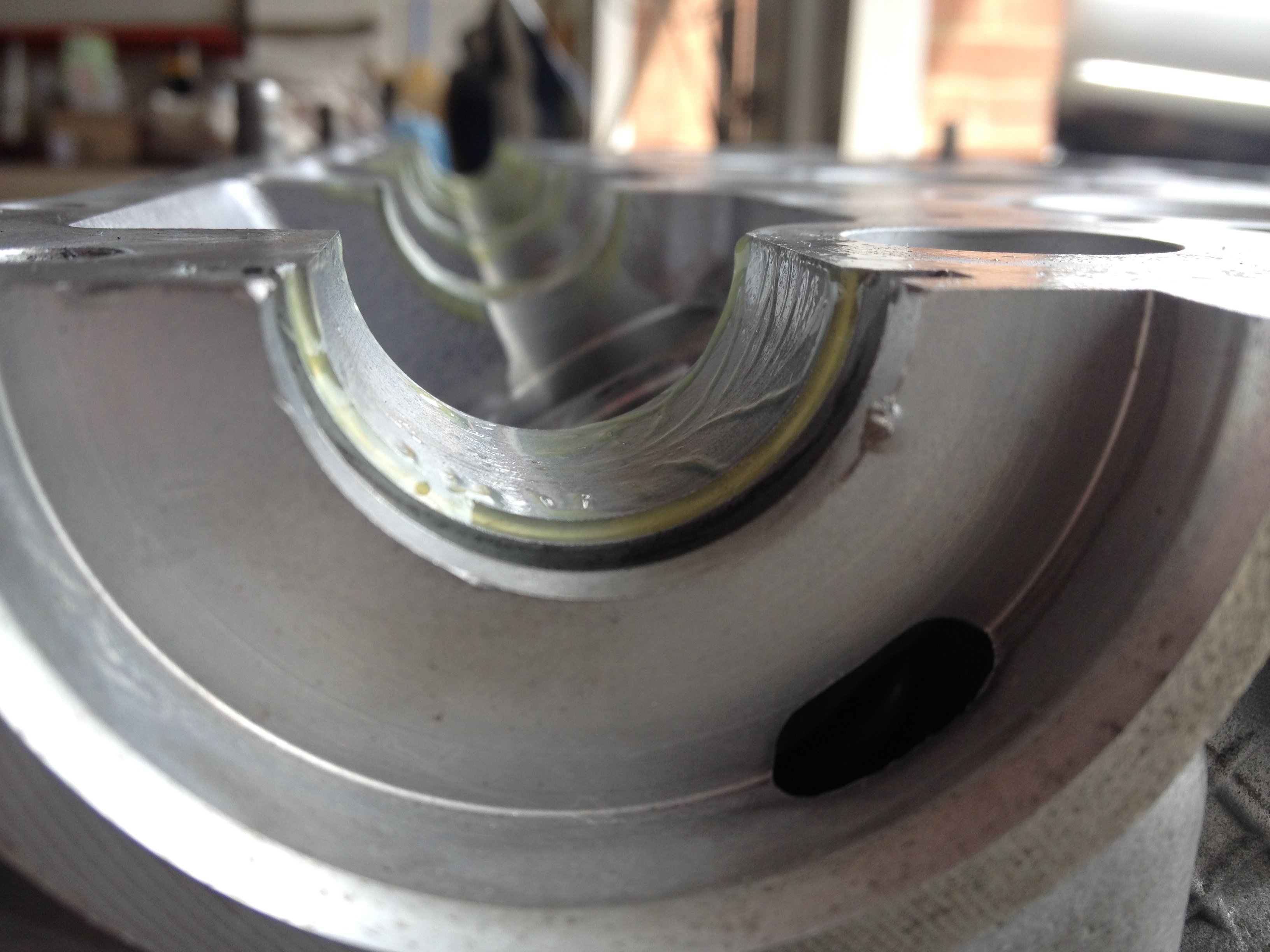

I purchased head for my '98 V70R last spring. There was damage to the exhaust cam front seal area (pics below). I contacted them by phone, and sent pictures by email. They said where the damage was is not a sealing surface, so it's OK. I took their word for it. I have been losing a large amount of oil since, and it appears to be coming from that area. That seal is the hardest of the 4 to get positioned correctly. So I have just assumed I failed to set it in right, and have been planning (and never making the time) for many months to replace it.
I also have puff of smoke at startup that seems like valve stem seals. I had that before the head job, and figured new head would have resolved. I can't conclusively say they're bad, but the symptom seems like it.
I don't know enough if that head damage is a problem, or if the smoke at startup is bad seals. I put it out there for some one who may know more. I will say they were quite responsive, and also accommodating on me not getting old head back in a timely manner.
