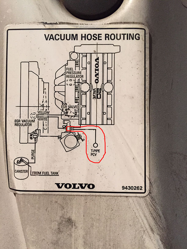

My '94 manual N/A car doesn't have that port either but that is a Jetronic LH 3.2 system. I'm trying to remember where the PCV lines go on that car and I'm coming up blank.

My brother has a 95 850 GLT and he has the same vacuum routing. My car was initially purchased out of state and brought to CA. I believe his has always been a CA car though.erikv11 wrote:Lucky you! Maybe it's a CA emissions variant, I don't know ...TBrown00 wrote: ...Mine just has the circle, but no hole or anything. It's a flush surface with the rest of the manifold.
Could you post up or PM me a pic of your emissions sticker? I would like to add it to another thread that talks about vacuum lines on NA cars.
PM sent. That thread was very helpful when I redid my vacuum lines recently. Glad to give back to it!
If anyone in this thread is interested I'm happy to post them here as well.

Here's my vacuum diagram and I've circled that line in red.Ozark Lee wrote:My '94 manual N/A car doesn't have that port either but that is a Jetronic LH 3.2 system. I'm trying to remember where the PCV lines go on that car and I'm coming up blank.
...Lee

TBrown00's car seems to be Motronic 4.3 with EGR and you don't see a lot of those, most 96's that I have seen are 4.4 with an air pump (http://new.volvocars.com/ownersdocs/199 ... n1996.html). Good to know, I added this configuration to https://www.matthewsvolvosite.com/forums ... =1&t=65002 on page 2.
