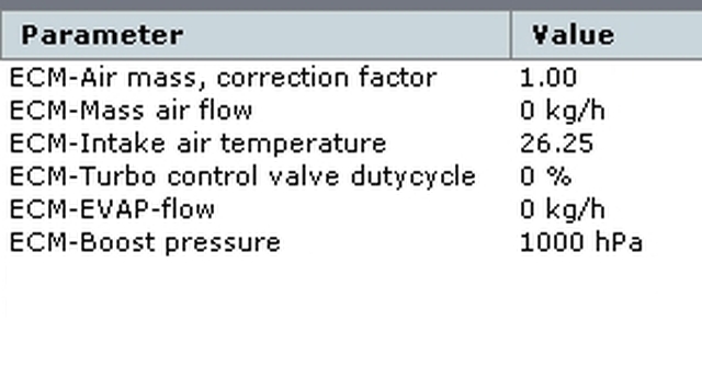

This is what Vida shows in idle;
your comments will be more than welcome.
So wires must be OK

I'm more concerned that the ECM believes there is no airflow through the MAF. Should be around 14kg/hr
This alone would influence all other readings. First thing I would try is ECM removal and cleanimg. This IS pointing to a faulty MAF however you need to measure the voltage supply at MAF before blaming it.
