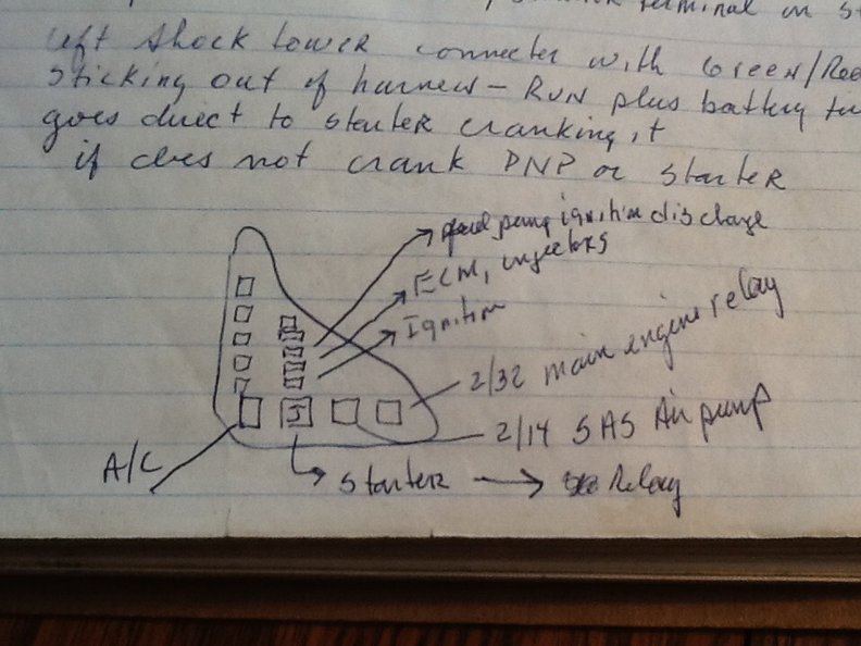

I am going on notes from several years ago so please bear with me....by the left strut tower there is a connector with green/red wire sticking out of harness- run this to the "plus" battery terminal as this will go direct to starter cranking the starter. Key is in position 2. If it does not crank then PNP switch or starter is bad. Can someone confirm this?
To test starter use a screw driver between the solenoid terminal and the large nut that the battery cable connects. Just one bump to see if the starter engages. Try to eliminate items in the chain by making them work. Plus the gearshift rowing as Scott pointed out, worked every time on a 94 850.
