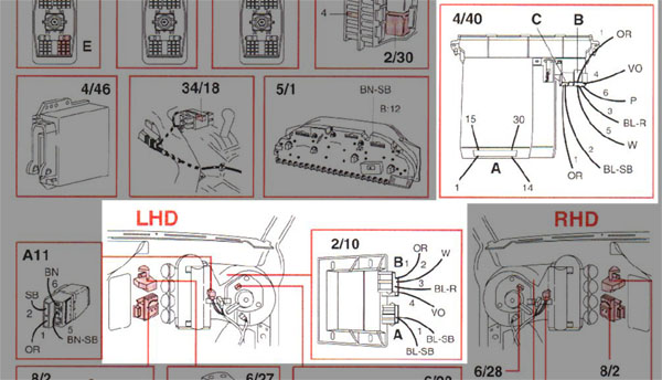

93Reg -- I had a chance to look closely at the green book diagrams you sent. My wiring colors are definitely going to be different than the previous diagram. Here's what mine should look like. I just wish I could see the connections inside the components, like on your other diagram, so I could figure out which wire does what.
I'm not a veteran at reading these things. I'm guessing the 4/40 B and C are the plugs going into the blower resistor from the control unit. Sorry for being a newbie at this.
And here's the component location with wiring colors
It would be nice to have the list of all the code numbers in the diagrams so I know what I'm looking at.

Comparing the diagram you sent with the arrow on it to this green book diagram, I may have decoded this.
- Your arrow (red/white) corresponds to connector A blue/black above, and is fan speed 5
- On connector B in the green book diagram...
- Orange is fan speed 4
- Blue/red is fan speed 3
- White is fan speed 2
- VO (violet/orange?) is fan speed 1
Resistances across connector B points should be lesser with speed 4 and greater with speed 1, right? What is a bad test going to look like?
