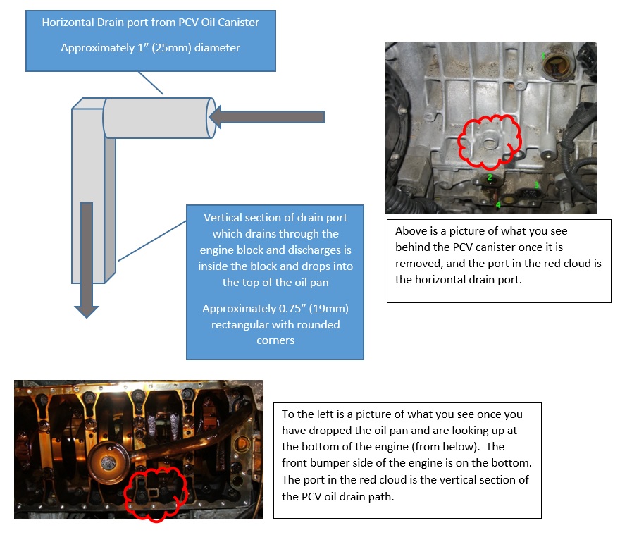

I just got through chasing this particular issue in my daughter's '07 S60 with 166K miles. (https://www.matthewsvolvosite.com/forums ... =9&t=76320). Do the work now, or you can find yourself leaking oil unexpectedly while on the road and getting into worse trouble (like my daughter did).
A COMPLETE PCV kit is available from IPDusa for $347. Shop charges for a PCV service will be $600-$800, depending on their hourly rates, and will probably not include a complete system replacement. I'm also not so sure that will include dropping the pan.
I CHOSE to drop the pan on mine, but was second-guessing that choice until I actually had it down. The horizontal drain port into the engine block was only partially plugged, so I expected to discover the vertical section of that drain port into the pan would also be open. HOWEVER, the vertical section was completely plugged right below where the port changes from horizontal to vertical, and I would NOT have been able to clean that out from the top side of the engine.
Also, get a new oil fill cap seal because it is probably already stiff and not sealing well from heat exposure. The replacement seal is only about $6-$8.
Also, you should plan on cleaning your throttle body while you have the intake off, and if you do this job yourself, you are going to need a crow's foot 10mm wrench to get the last bolt on the bottom by the power steering pump.

Not a stupid question at all, and I apologize for having not been more clear, but was trying to avoid my tendency towards being too verbose.
Yes, there is an "oil box" (Volvo calls it a canister), and it is located under the intake manifold and you cannot get to it without removing the intake manifold (and several other items like the intercooler to turbo pipe running over the top of the engine and the fan shroud), and you can see the setup in the picture below.
"Dropping the pan" means removing the oil pan from under the engine. That is the only way to ensure that the entire oil drain port is clear because you cannot gain access into the vertical section from the horizontal section above. The sketch below show you what I'm referring to.

If you look at the hoses in the bottom picture above, you can see there are coolant hoses
A good mechanic will try to persuade against breaking a 11 year old coolant line off its fittings and reinstalling it, especially since you can't see it if it starts leaking,and will recommend replacing it with new parts (since the labour is already being done)
