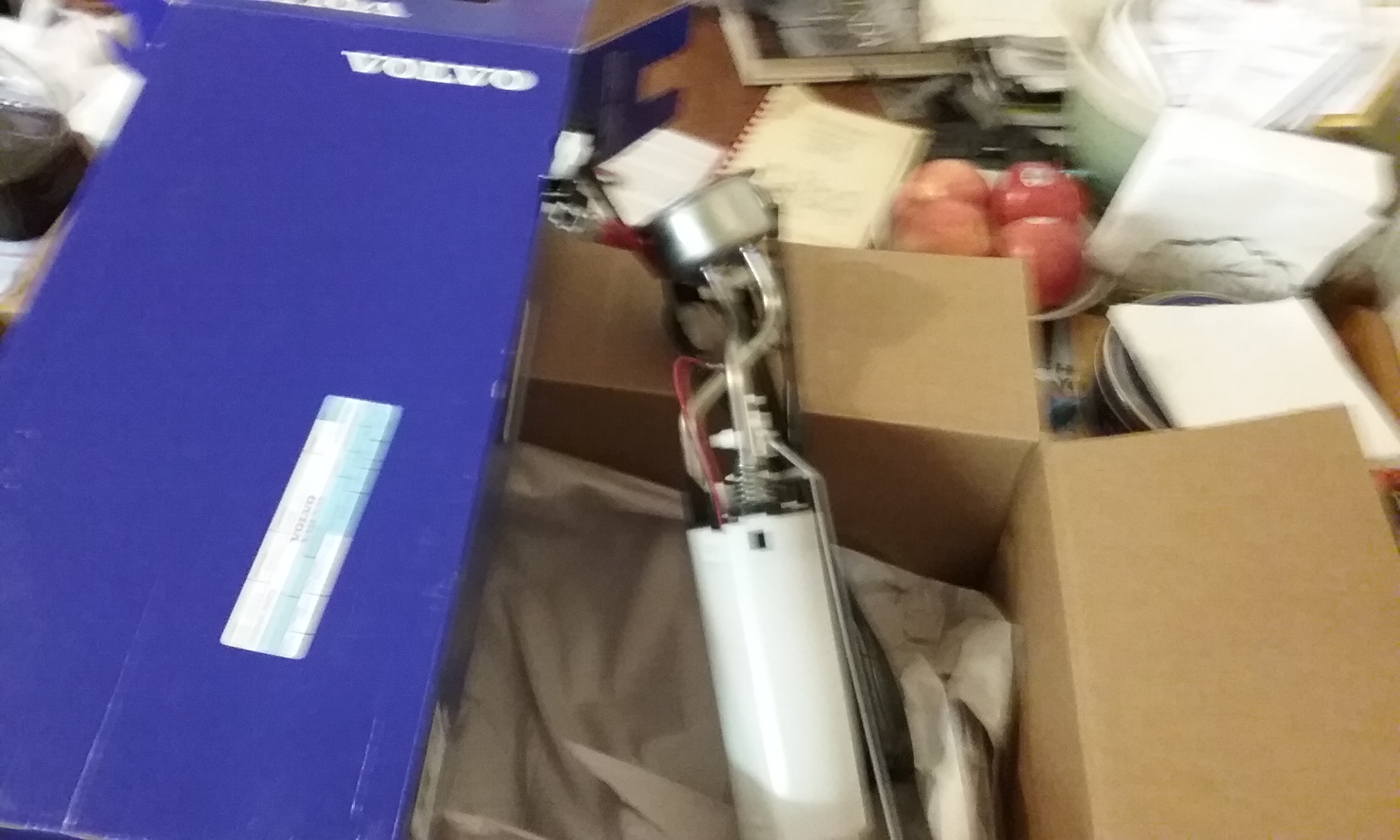

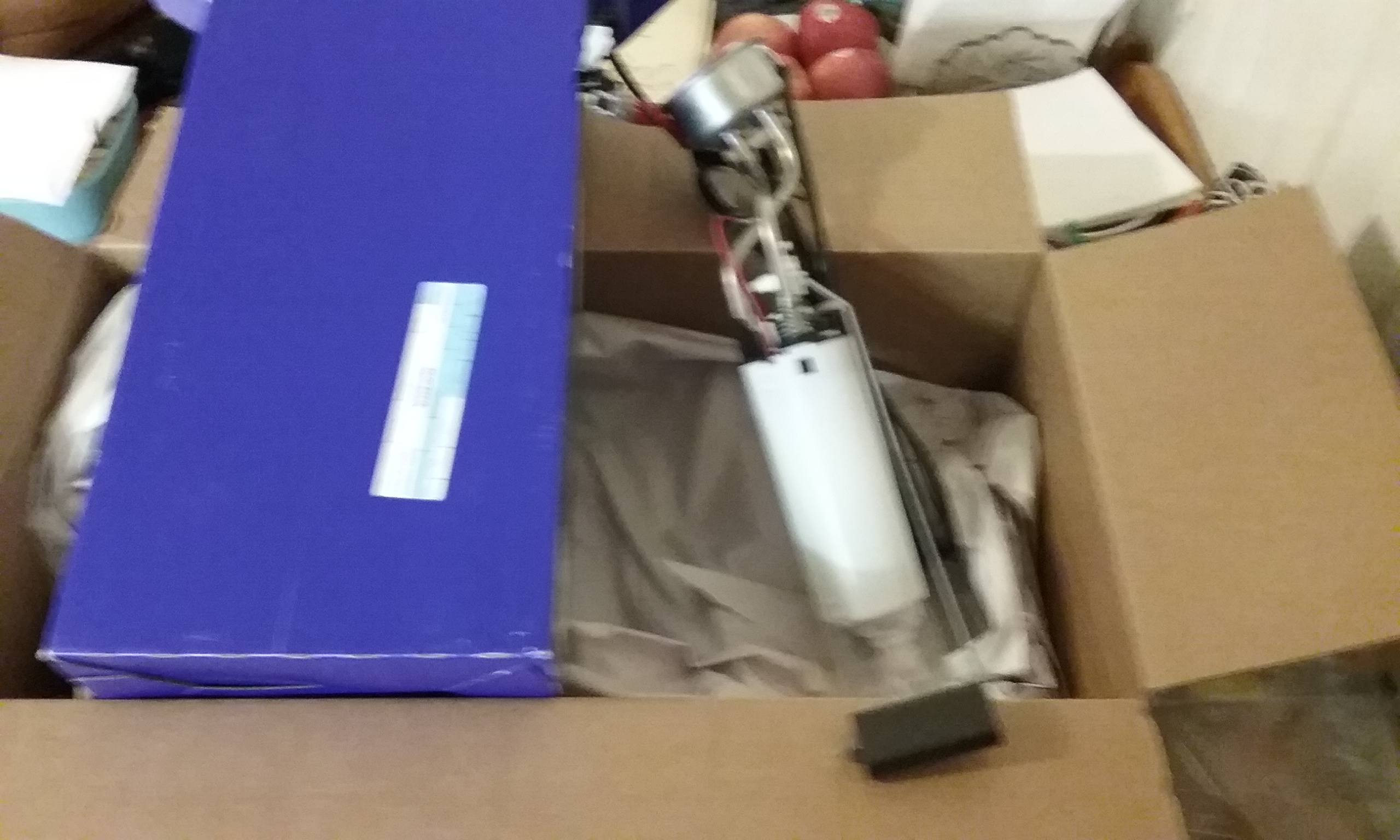

After replacing my fuel pump during the summer with a new assembly it died already. From day 1 it was very loud, you could hear it running all the time. Luckily I purchased it from FCP and they took care of the issue. It was a Proparts Sweden FP assembly and FCP actually is getting rid of that particular part from there site. Anyway I got the real McCoy, Genuine Volvo FP assembly.

- Posts: 15510
- Has thanked: 2212 times
Particularly on an AWD I know they are really expensive, but OE for me is he way to go unless you are wanting to cut hole in your floor. The huge amount of work involved it makes sense. Good luck 2nd time around!

Yeah i wasn't happy about it after I finished install first time, I couldn't believe how loud it was. I knew it was faulty after testing it. I ran it until it died, I had the Volvo pump in it's blue box waiting at home already for the day the ProParts Sweden pump died. 6 months .scot850 wrote:Particularly on an AWD I know they are really expensive, but OE for me is he way to go unless you are wanting to cut hole in your floor. The huge amount of work involved it makes sense. Good luck 2nd time around!
