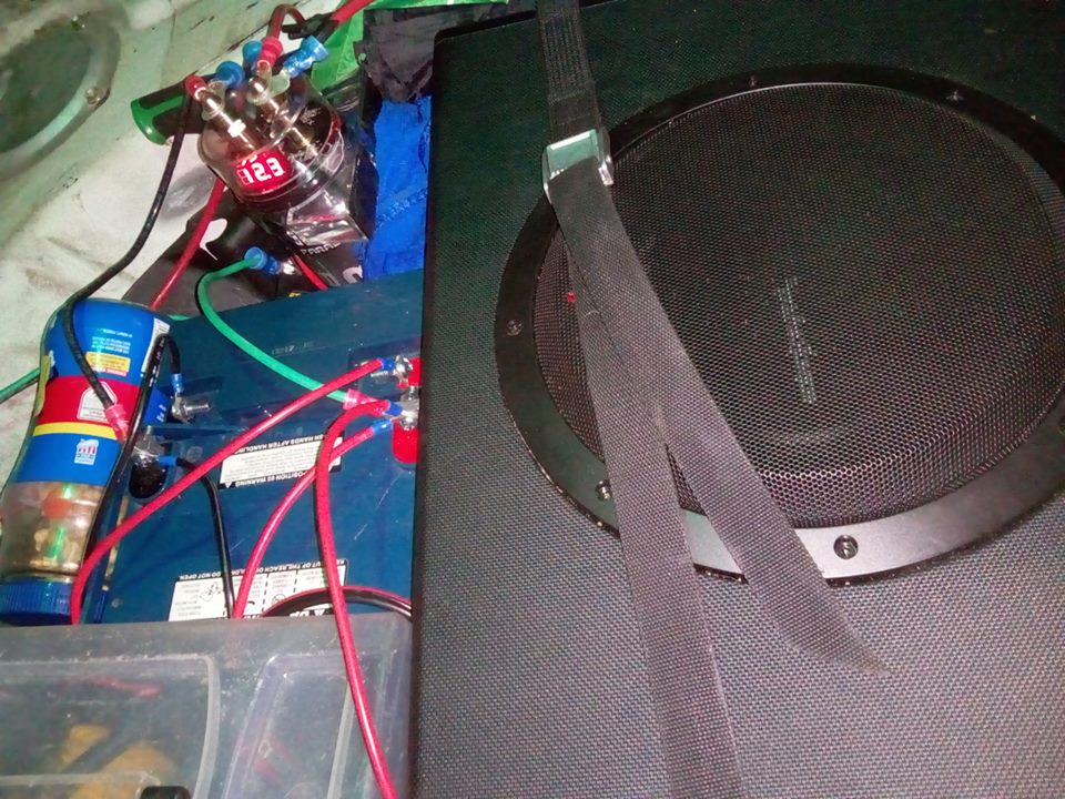

I havent checked my voltage lately, but I have around 380k with an original alternator and a 10 inch subwoofer along with 10 meters of LED light strips connected to my car. I have a 1 farad capacitor before my sub, but I still haven't replaced my alternator regulator yet. However, I do have one on hang in case it goes out.

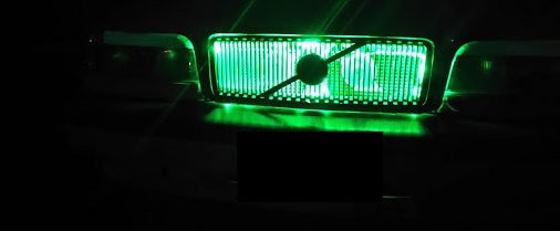

Night-time pic, or it's a lie....firestarterpro wrote:I haven't checked my voltage lately, but I have around 380k with an original alternator and a 10 inch subwoofer along with 10 meters of LED light strips connected to my car

dyn blin wrote:Night-time pic, or it's a lie....firestarterpro wrote:I haven't checked my voltage lately, but I have around 380k with an original alternator and a 10 inch subwoofer along with 10 meters of LED light strips connected to my car
I never told a lie
