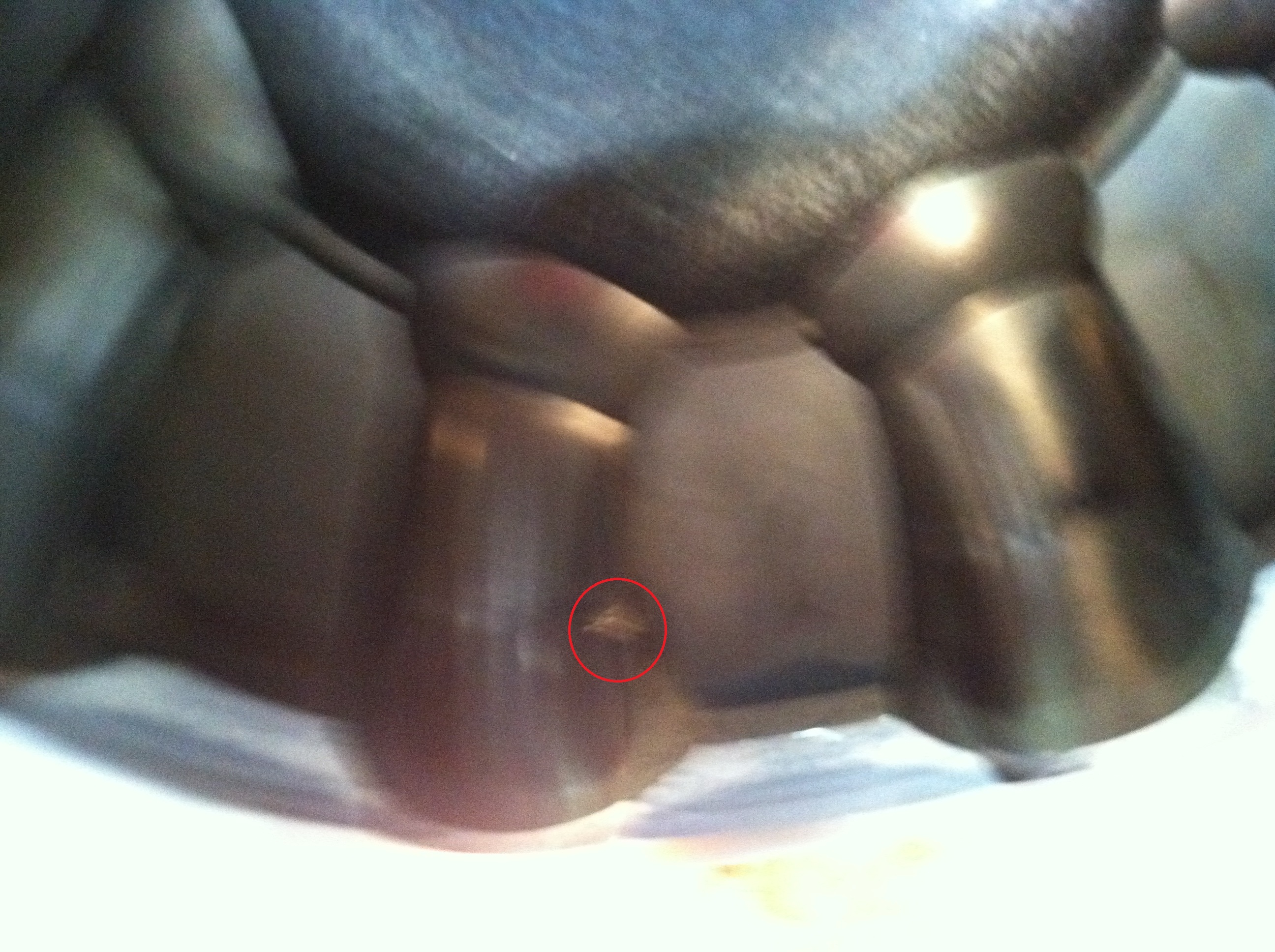

Mine had water in the inner joint (light brown goo that flowed out) and small flakes off the edge of two the bearing grooves(I have a picture but its not in focus). I'm not sure its worth rebuilding with those flaws...
What do you think about the condition, worth rebuilding or no?
Its an extra an I have no immediate need for it, although the one on the car is going bad - it vibrates a bit and is slowly getting worse.

As long as you HAD no noise (clunking noise) before the rebuild, I'd re-use the axle, even though it didn't look "perfect".
A few imperfections are fine, nothing to worry about.
Remember these are GKN quality axles, they are excellent in terms of engineering and quality.
Once you clean out the water, dry it and pack with new grease, you are good.

Thanks. Got the part at the junkyard so I have no Idea about its prior performance. I cleaned out as much grease as I could but had to leave some in on the side with water - I spent a good half hour doing it- not much left with water in it but definitely some left.cn90 wrote:As long as you HAD no noise (clunking noise) before the rebuild, I'd re-use the axle, even though it didn't look "perfect".
I've got a picture of the imperfection Slightly out of focus) - will upload after lunch.

Your comment about drying out the side with water in the grease is a good one - I didn't think of that and that side is already buttoned up. I was pretty meticulous about cleaning out the watery grease but there was definitely some still in there when I was done, I'd guess maybe a tablespoon or so in the recesses.
The picture of the chipped spot is attached. It was difficult to keep it in focus and get enough light on it for the spot to show up. Its about 1/16 wide and maybe a little longer in the axis direction- circled in red. The other dark grey marks are just discolorations in the surface
I may have made the chip with the drift but I don't think so. I used soft metal for the drift and was very careful about where I placed it - always as far inward on the star near the splines as possible and never near the outer edge.
On a related topic my dealer has an internet price for the OE axle of about $430 which isn't that bad. I know that's a hefty price compared to aftermarket or a rebuild but I am tempted to just buy one since it should be the best quality available I'll never have to replace it again - at least in theory.
