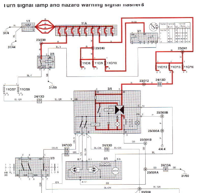

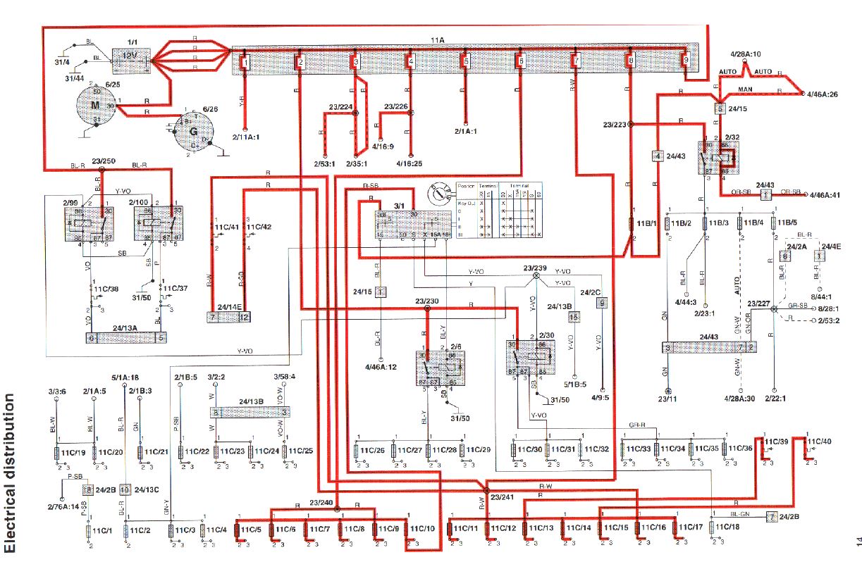

Someone grab the 1998 power wiring diagram off the webs and post here please, so we can talk Dave through this.

From that diagram it looks like bad battery or ground cable are needed to take out dash lights
Bad ground you can diagnose running a jumper from battery to engine block
Bad battery if that doesn't work.
Bad alternator diodes could be draining battery but you usually get some signs of either life ( weak crank, dim lights) or death ( diodes cooking)
