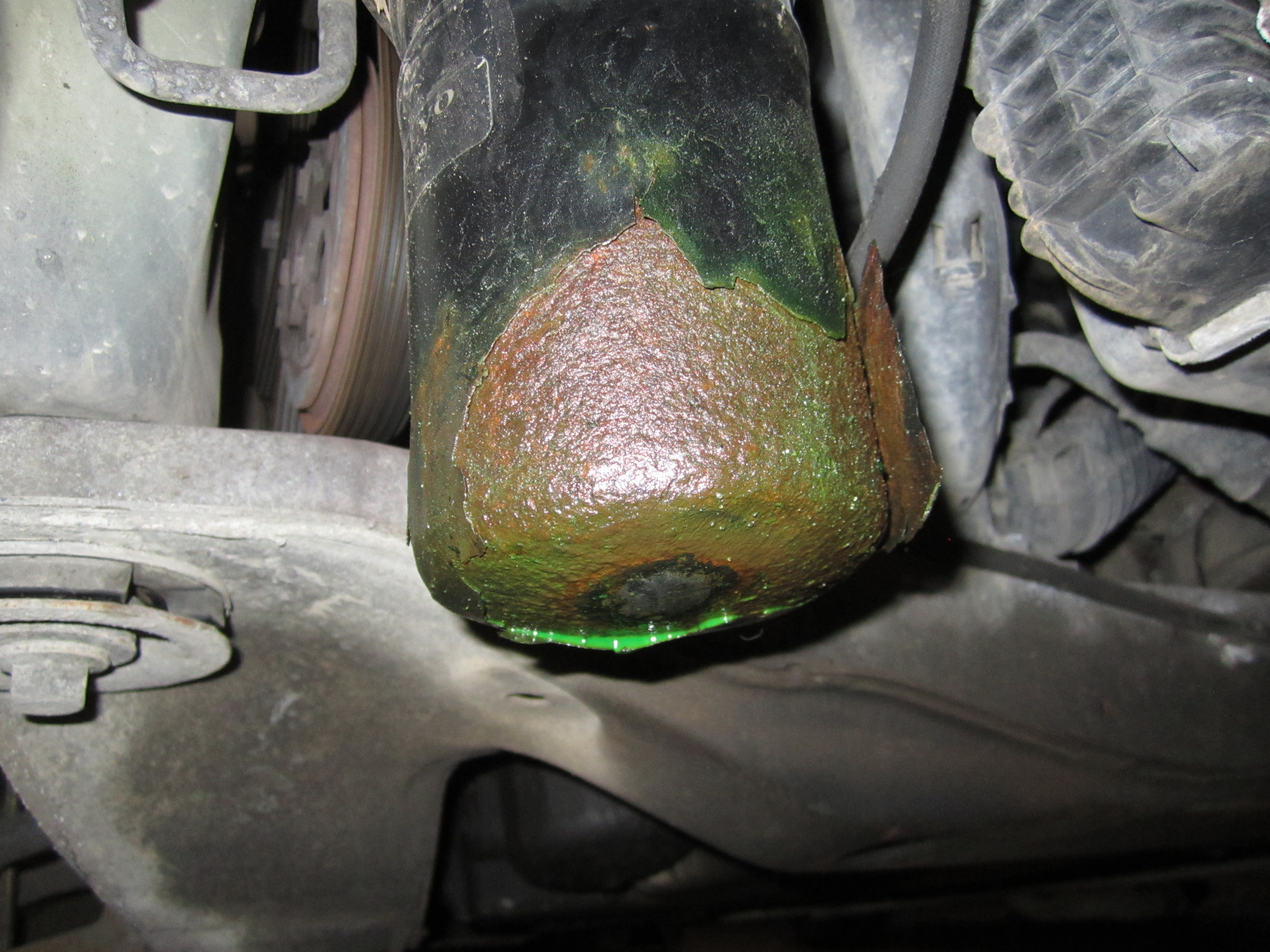

Well onto todays rant! What is it with Volvo engineers and the use of dis-similar metals threaded together?
Today decided to stop procrastinating on replacing the holed dryer/accumulator on the project V70. Done this job a few times before and hate doing it as there is limited room to undo the spring clip at the top to remove it. Surprisingly today it undid really easily. That was just to fool me into finding out the large threaded pipe connector onto the top of the dryer would not undo. The original dryer used what looks like brass or an alloy as the threaded male connector on the dryer and a steel female threaded fitment on the pipe to the back of the A/C compressor. No matter how much force I allied it would not loosen from the pipe.
Eventually I had to cut the dryer off below the connector and then tried a six point wrench on it rather than an open wrench as it was rounding the threaded 'nut'. Still could not undo it, tried heat but still nothing. In the end I had to pull the radiator fan to give room to access the internal hex bolt at the back of the compressor to remove the whole pipe.
Naturally the 'O' ring is not in stock at the dealer. When I got the pipe end into the bench vice I found the hex end on the dryer threaded portion had actually deformed out of the hex. In the end I had to use a large set of pipe pliers to lock onto it to get it off. The internal portion of the pipe end had rusted and the dissimilar metals had fused partially preventing being undone easily or even with difficulty!
So once again I have had to do way more work than needed because of poor design methods on Volvos. When will those idiots ever learn that cold wet conditions where salt is used just does not work when mixing materials (e.g. the whole rear sub-frame fiasco on my AWD 'R').
Only reason it was not as bad as all that is I was planning to remove the cooling fan to access the top nut for the front engine mount when swapping it out. Also gives room to access and clean a lot of the oil from the front of the engine and ancillaries that had leaked from the PS pump (bad hose clamp) and the leaking A/C dryer.
Old leaking dryer
Old leaking dryer
Now just have to wait for the 'O' ring to be able to re-assemble. Checked with the local repair shop and they asked that I not put PAG oil into the new dryer so they can do that as part of the system re-pressurising. Saves having to buy yet more PAG46 oil for it to sit on a shelf with only a little used!
Nice to see the old dryer was stamped made in CANADA and the new one Made in China! New one feels as heavy as the original but the threaded connection to the flex pipe to the compressor looks cheap and nasty.
Question: How do you tighten something which you cannot fit a socket onto, to 30NM?
