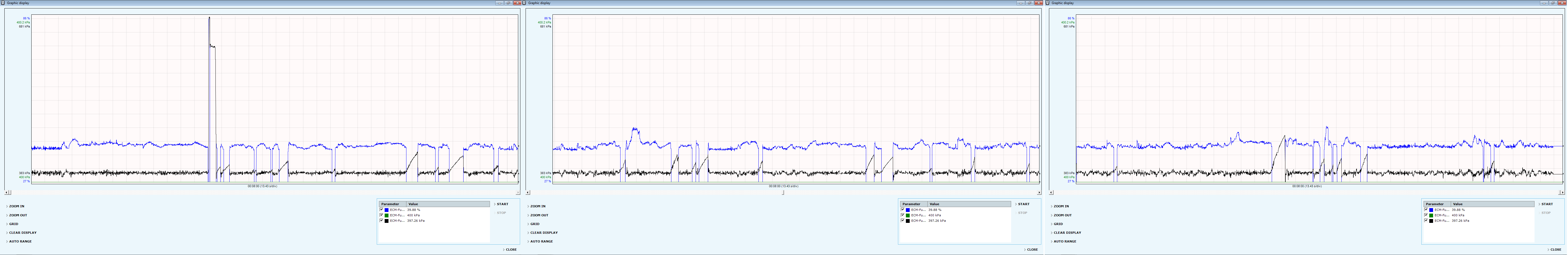

zjevik
- Posts: 52
- Joined: 06 May 2015, 09:33
- Year and Model: S60 2006
- Location: Miami
- Has thanked: 1 time
Everything looked normal today. There is one spike to 680kPa when I floored it but the pressure never dropped below 380kPa.
The car drives good and I feel like I am trying to find something wrong with it. It is 11 years old and has 118k so getting a code here and there is I guess not a big deal
Thanks guys for your help!
Here are the data:
Here are the data:
- mrbrian200
- Posts: 1554
- Joined: 20 Jan 2016, 08:47
- Has thanked: 7 times
- Been thanked: 84 times
I don't like the spike. That most likely some sort of electrical disturbance (I doubt the pressure actually spiked to 680kpa). By '06 they had deleted the fuel pressure damper on the rail. It is possible it happened to capture that instant one of the injectors closed and that's a fluid hammer. I have toyed with the idea of drilling/tapping a hole into my rail and adding the pressure damper back where it was on the older ones. They changed the way the fuel line connects I don't think I can simply pull a rail of an older one that has it already.
