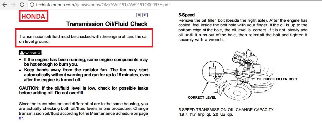

It is a valid assumption.
Virtually all Honda car owner's manuals state that "Check ATF level with engine OFF".
Personally, I think Volvo makes it to complicated.
See the Honda ATF checking procedure:

It appears that the Honda checking procedure that is referenced may be for a manual transmission.
However, the OP is inquiring about a Volvo automatic transmission.
I don't see how you can compare the two or what is particularly complicated about Volvo's procedure.
OP, I' say keep doing what you're doing.

I used to own a Honda Odyssey van, the ATF is checked with engine OFF.
In the Honda, I have done the experiment (engine OFF), the difference between COLD and HOT engine is about 1 cm on the dipstick.
I personally think if you have done the experiment (measuring level first thing in the morning and know where it should be), you should be able to check your ATF COLD in the morning without issues.
http://www.odyclub.com/forums/24-1999-2 ... level.html
