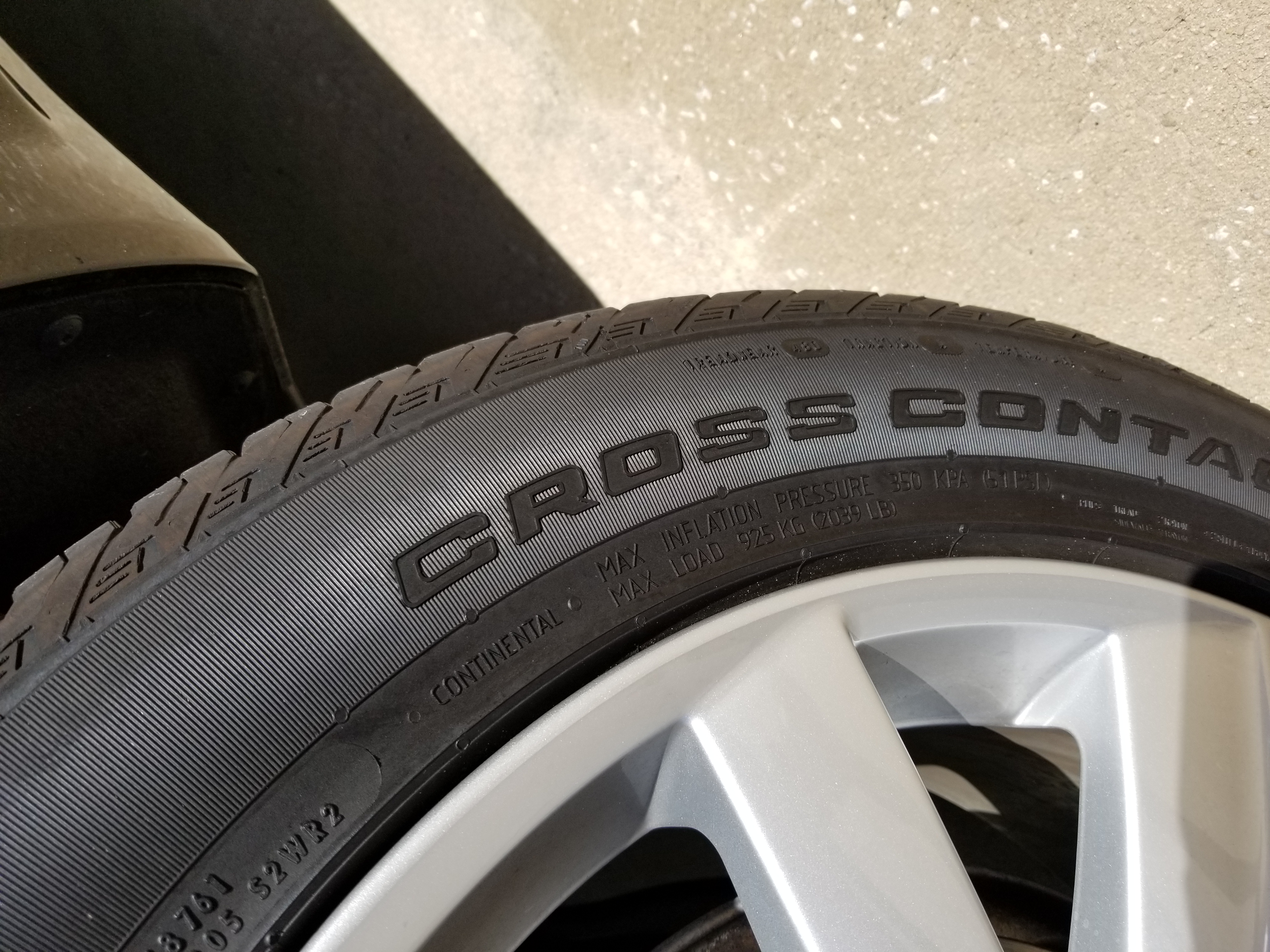

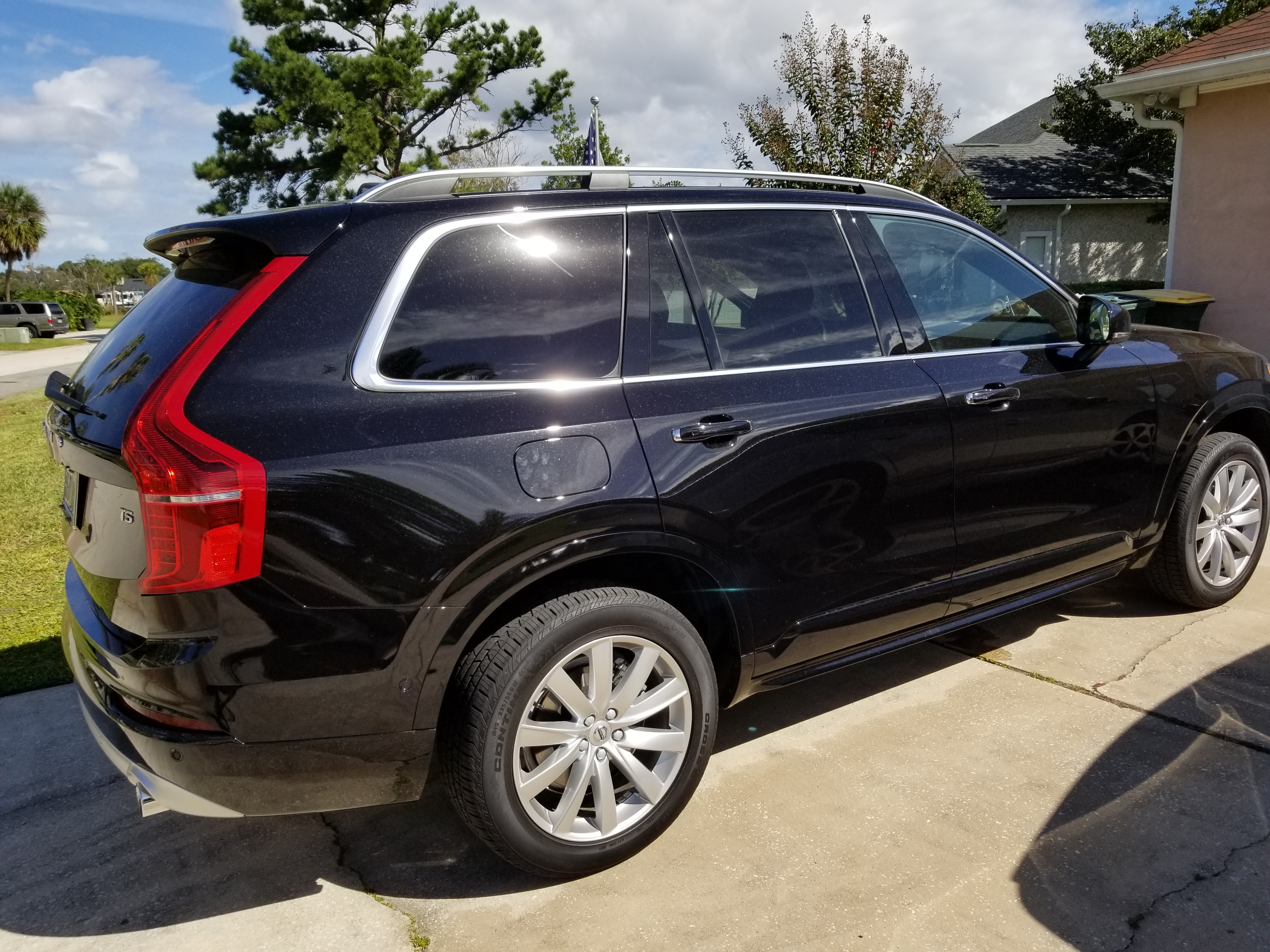

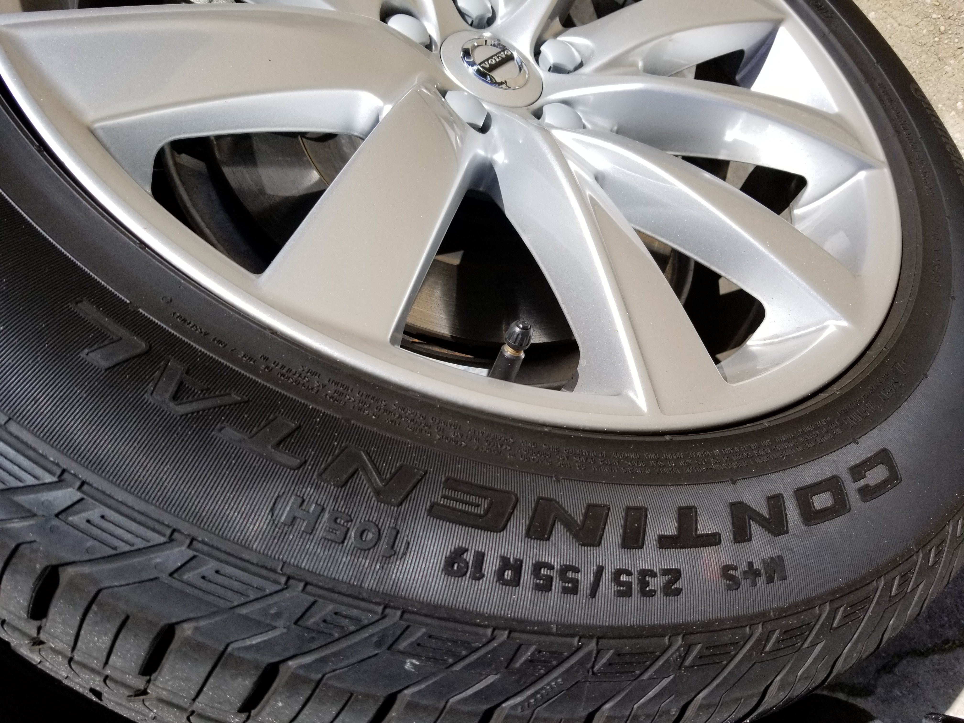

Form personal experience with two Volvo cars bought new with factory Perelli tires, when replacement is due select a Volvo approved alternative tire. I had trouble with both sets and in the second car's case drove it three years with Michelin without problems I had with the Perelli factory set. Ask your service advisor for the list of Volvo approved tires for your model and research each option before deciding. Notice the 2018 XC90 T5 service loaner I am currently driving has Continental factory tires. June
