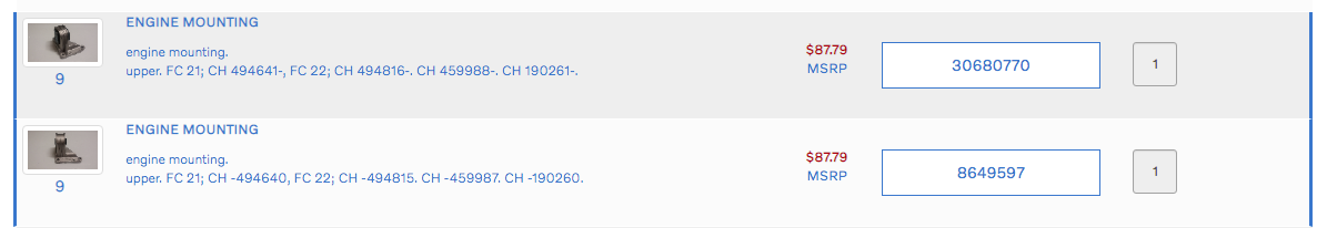

The original when I bought the car was circular, which makes sense since it's a 2001 model, but both of the replacements I've installed have been the square type. I had interpreted the bold text in this note on IPD's site to mean that I could use either style mount in my 2001 model (if the dealer could use it as a replacement, so could I...):
Most 2005 and later 5 cylinder models use a square style upper engine mount. If you have the square style mount, you can replace it with either style. Please note that some 1999-2004 models have the square mount installed by dealerships as a replacement.
But now I'm wondering if that's not the case, especially if the dealer made other modifications than just swapping out the mount (e.g. modifications to the torque arm or mounting nut/bolt). In fact, I now see that if I were to go strictly by Volvo's parts site, the specified mount for my chassis and factory code would be the circular type:
Two Types
Two Types
Screen Shot 2019-05-01 at 12.12.30 PM.png (49.18 KiB) Viewed 782 times
My car is factory code 2, chassis number 077411. 30680770 is the square type and 8649597 is the circular type.
I'm wondering if I wouldn't have better luck with the circular type. Or if there are additional modifications I could make that would make the square type work better.
