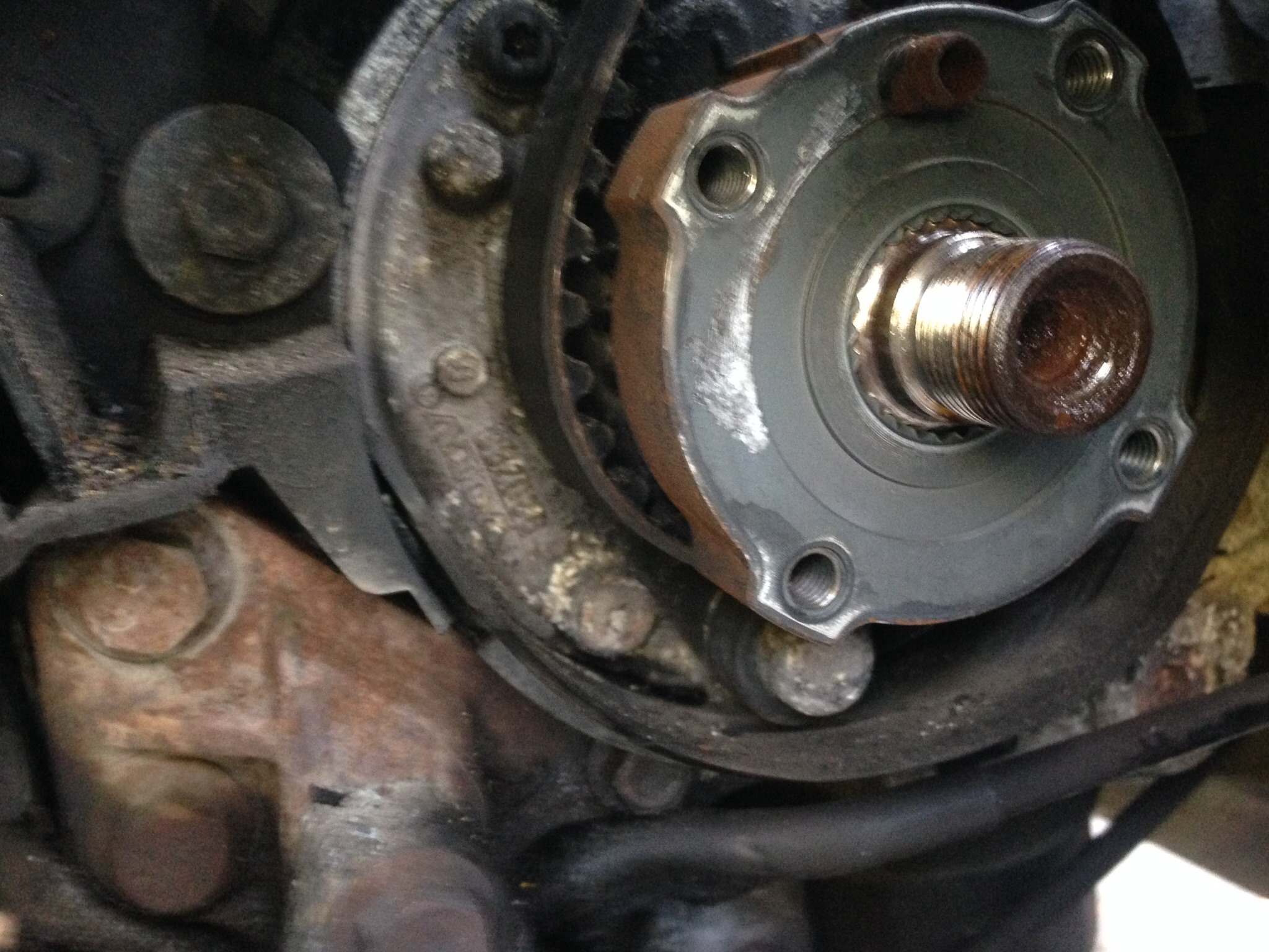

Thx wcm. Popped the belt back on today. Will confirm timing marks , re lock cams, and then torque hubs back to spec
- Posts: 36165
- Has thanked: 1611 times
- Been thanked: 4075 times

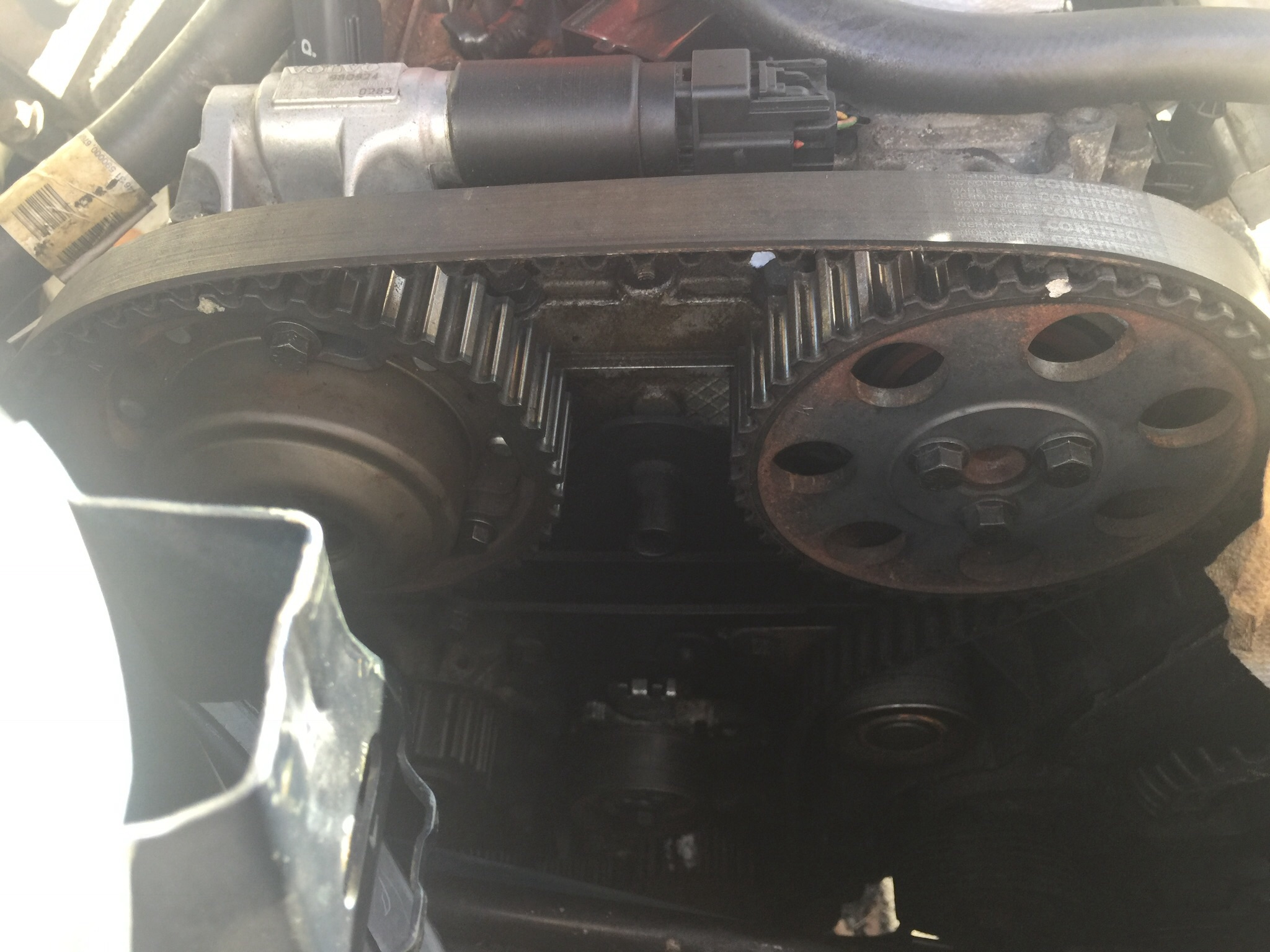

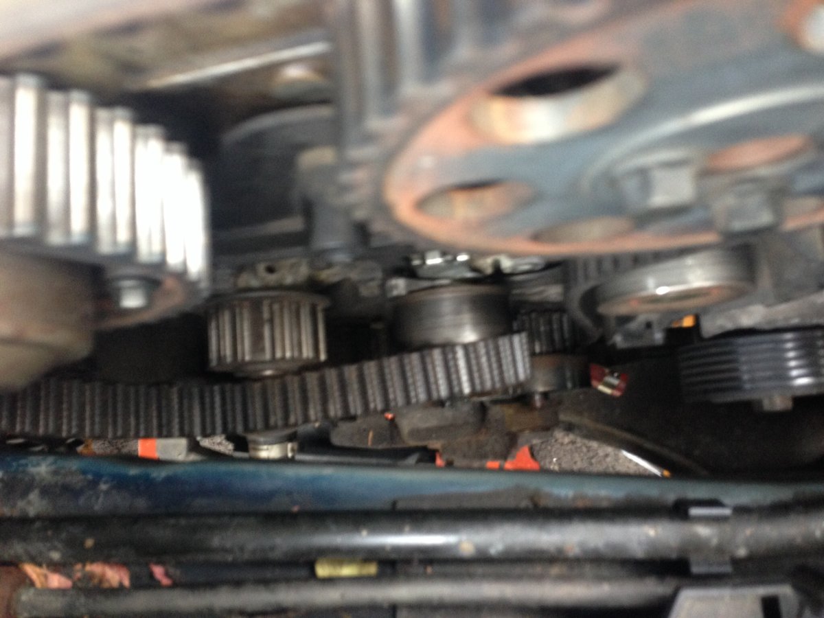

Well, belt wasn't on right and now it's kicking my butt. I took off the harmonic balancer but can't get tension from the crank pulley to the intake cam that holds. I tried by trick of a wood wedge to hold tension on the bottom cam and that failed too.

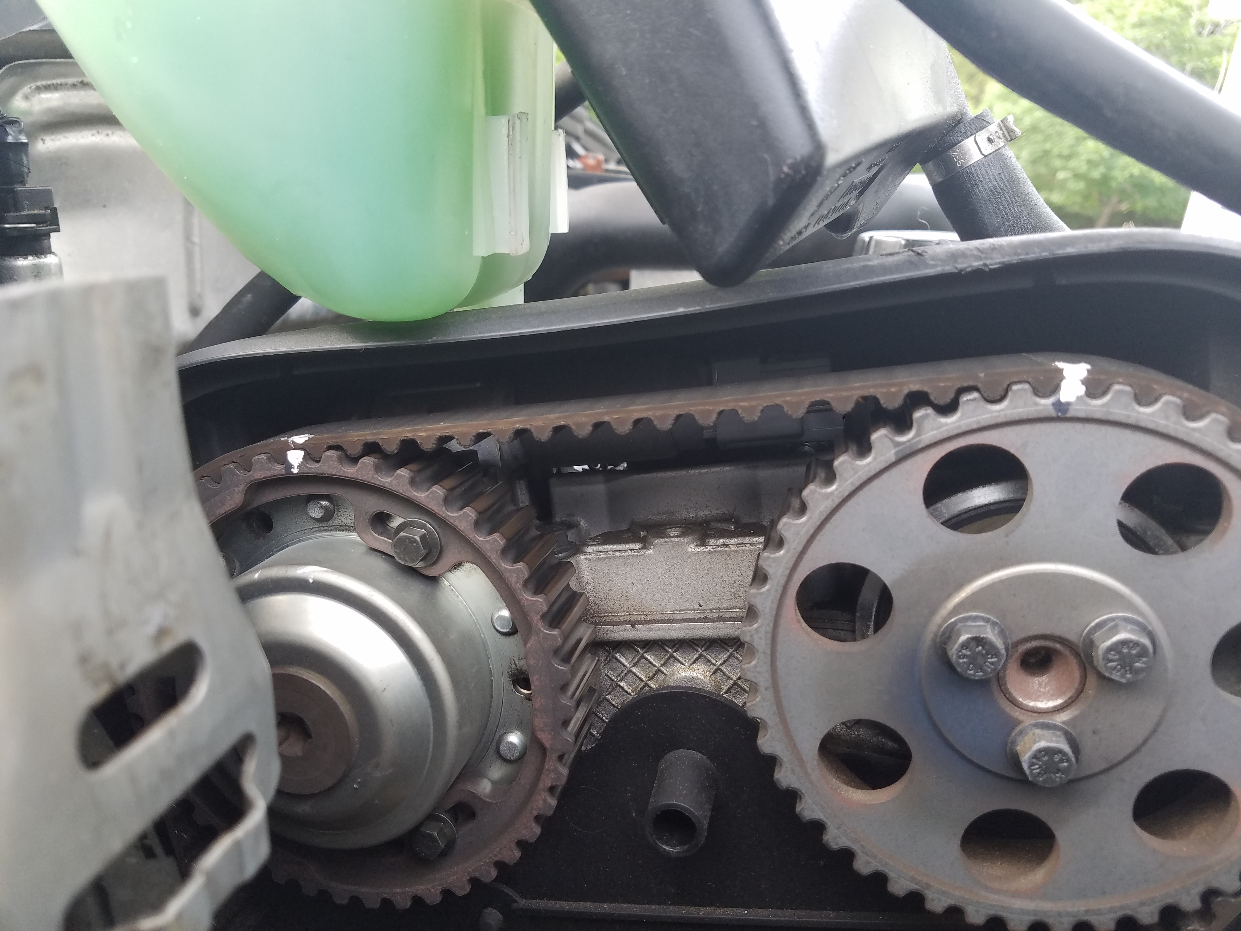

Use rubber-ended woodworking clamps to hold the belt on the top edge of the two cam sprockets to maintain the preload on your exhaust cam. In the attached pic (shamelessly stolen from a thread by deepsouth), you'd put the clamps where he's got the white-out marks. Then, with the cams locked at the rear, your hands are free to work on the rest of the belt.
I found that I had to slip the belt onto the crank pulley with the crank two teeth clockwise from TDC, get the belt between the sprocket teeth, then spin the crank CCW to TDC. If I did two teeth, it would naturally take up the slack and end at TDC with the belt taut. Your results may vary, depending on the belt and how far you've got your car disassembled. At that point the belt was taut on the intake cam, exhaust cam, water pump, and crank pulley; the last item is the tensioner, which, once you slide the belt onto it, will hold the belt in place while you set the tension and torque the bolt.
