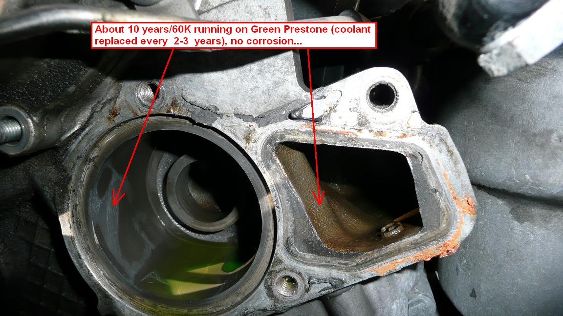

A word on Prestone and my 1998 BMW 528i with 170K.
Bought the car in May 2006 with 90K (dealer serviced up to that point), now the BMW is with me 11y/80K later, replaced with Prestone green coolant every 2-3y.
See the inside of the BMW engine (ignore the RTV gasket that I did not clean when photo was taken), pristine inside with no corrosion after 20 years of its life, not bad at all for Prestone green.

That last part, not using water full of unknown dirt, is i believe more importan than the brand on the bottle. Only applies if not buying ready to use of course.MarcM wrote: 11 Dec 2017, 05:36 I run Pentosin Pentofrost NF mixed 50/50 with distilled water. That's my 2 cents.
That BMW picture above looks a bit dirty to me. My water pump was much cleaner even though the coolant was a bit mud coloured.
