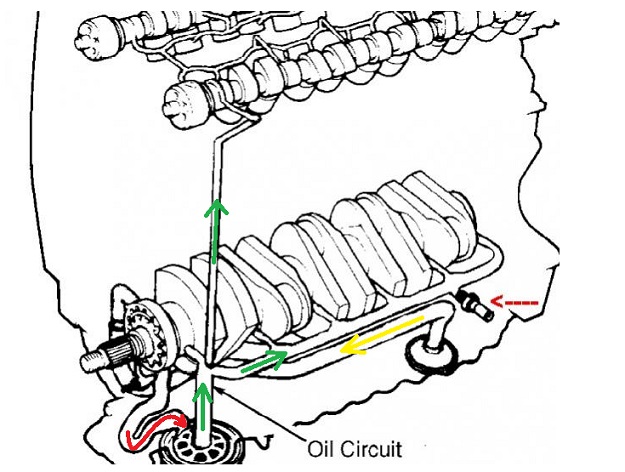

I am no oil pressure guru, but I have gathered some info, which I think is useful to understand.
1. Oil Pump sucks oil from the pick-up screen, then pumps it downward through the OUTER aspect of the Oil Filter (Red Arrow).
- Then oil is filtered and exits the Oil Filter at the very center (GREEN Arrow), feeding the crank, cam etc.
- Excess oil is bled via Relief Valve (YELLOW Arrow).

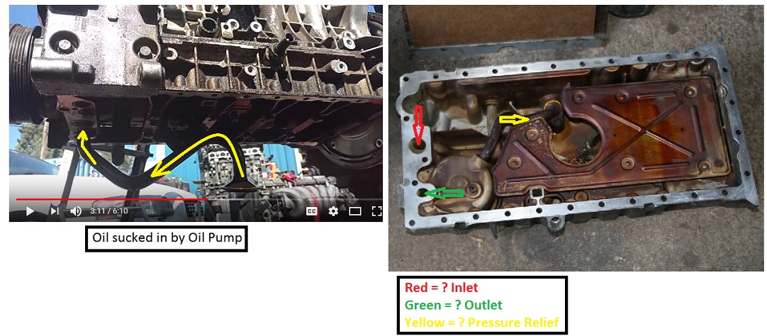

2. Another pic:
3. How Oil Pump works, this guy did a very good job explaining how a Toyota Oil Pump works:
[youtube][/youtube]
To summarize it, the only way for you to have metals at that location just above the Oil Filter: they have to come from the Oil Pump itself, which I find hard to believe b/c these oil pumps last the life of the car. Unless abused by P.O. by extended oil change intervals with sludge etc.
