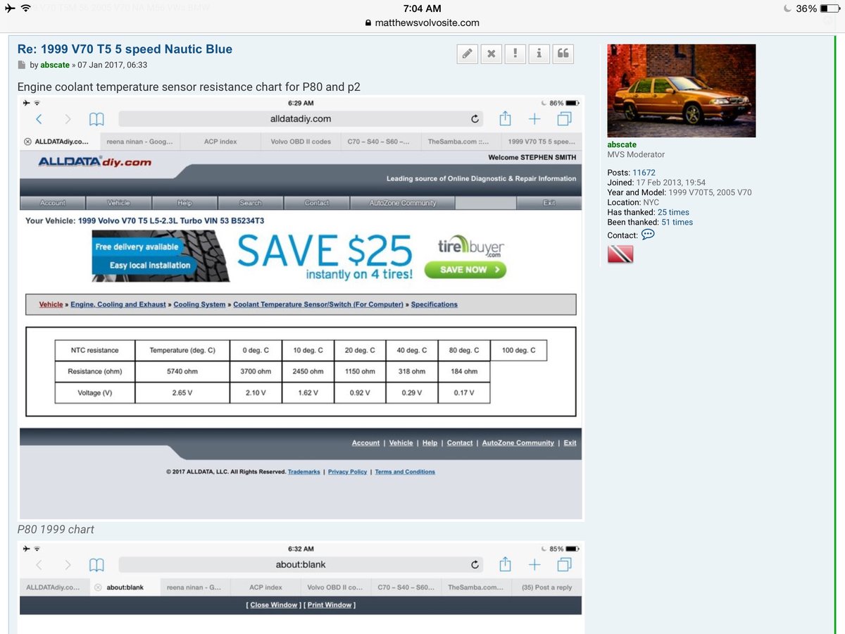

Look for 1999 resistance chart as the 99- has a different sensor than the -98
Part 9125463 for 1999-2004 applications

I just remembered the table above has an error, if you look you can see how the numbers are not tBulated correctly , they are offset one column to the left

I know about the table, I put the numbers correctly in the graph.
